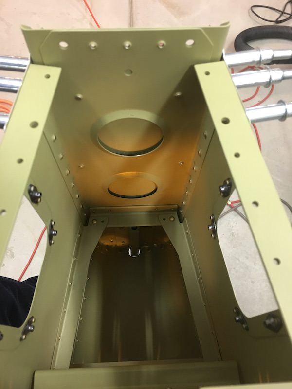

Emp page 10-20 Step 7- "... Rivet the stiffeners to the F-1056 rudder stop brace using AN470AD4-4 rivets"
I am not sure how to reach these 4 rivets. My double offset set isn't long enough (or offset enough) for my gun to clear the longerons. The squeezer can't reach it either.
How have others gotten to these rivets? I see Aircraft Spruce has a 10-1/2" length 1/8" straight set. I'm thinking this may be the way to go--if it'll clear the longerons that is. I figured it would be wise to ask here first. Thoughts?
Pictured are the holes in question. I have rivets in two of the four the holes, one on each side:
