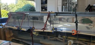

Here's what I came up with to get the skin out of the way while I try to reach the most aft rivets. Seems like it might work. At least I can reach them with my bucking bar in one hand while banging with the other. We'll see. Hopefully, the fact that six of the seven straps are not Snap-Ons will not affect the results. :)

I did it this way with duct tape on both loose edges, so I could rivet from the center outward.
