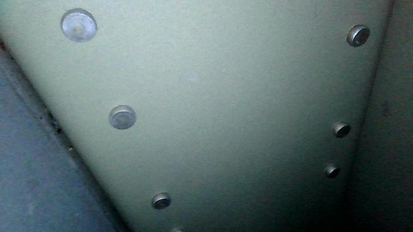

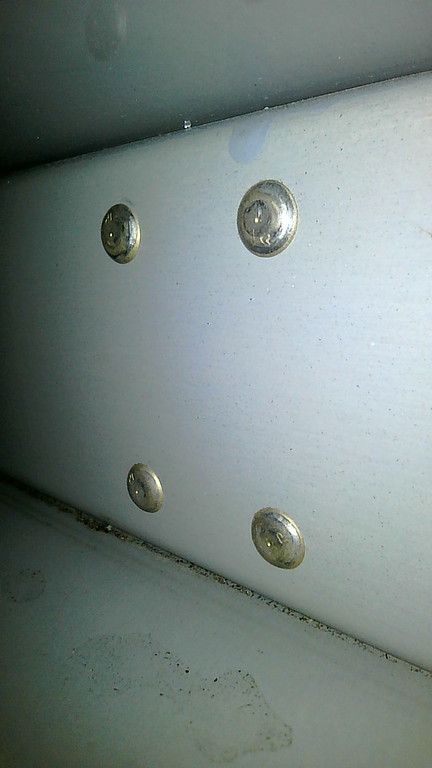

I received the new hinge brackets today. THESE ARE THE BRACKETS THAT VANS HAS REJECTED. One of my concerns with the non pre punched stabilizer is the rivet spacing on the rear spar adjacent to the hinge brackets is not uniform from build to build. This is the case on my stabilizer, the rivets that are supposed to go through the new bracket and the skin and rear spar will not have adequate edge distance on the hinge bracket. I hope this issue is addressed with the new brackets that are in the works.
I note that with just a flashlight I can see the forward rear spar part of the outboard brackets just fine through the lightening holes in the end ribs of my RV-9A. Getting an endoscope in there for a definitive inspection should be straightforward, in the RV-9/9A at least, if one thinks that is necessary. No drilling required. Zooming in the photograph makes me pretty confident that an endoscope isn't required either (for the -9/9A).

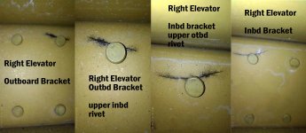

I had to replace my horizontal stab and elevator back in 2015. I found a completed stab and elevator and installed them on my 8. At that time my airframe had 2250 hours on it. It now has 3300 hours, so a bit over a thousand hours on the new stab and most definitely some acro..
As you can see from the photo's I do have 2 cracks on the right hand, outboard elevator attach brackets. The left brackets have none. The rivet where the crack is on the outboard attach point was obviously not set properly. The inbd attach point also has a crack in the upper adjacent to the crack in the outboard one. This leads me to believe that the reason for the crack may be poor assembly in the first place. Just speculation, but it was not build properly.
Also, I plan on replacing both sides when the parts are available since I can see other rivets that just aren't right here.

Good and Bad
Jerry, my crack is identical to your right side, outboard bracket, upper inboard rivet. What should a proper rivet look like?.
Properly set. there are gauges to check proper height and diameter.
Not Proper. Not how the shop head is bent, not round and not even around the hole. I didn't build either, but this is pretty obvious...

Bad riveting
My guess is the spiral slipstream caused by descending prop puts a greater load on right horizontal stab. Jerry, my crack is identical to your right side, outboard bracket, upper inboard rivet. What should a proper rivet look like? I have 950 hrs on 2004 rv8 with little aerobatics. I guess it’s not so obvious to a non builder.
Tracy, looking at the top inside rivet in your photo, it’s not squeezed properly either. And on the opposite bracket, the top and bottom rivets closest in don’t look right either. Just speculating here, but the way it looks, it can’t be distributing the load as it should.
I was concerned about some of the shop heads on the bracket rivets on my RV-6, they looked over-driven. Then I figured out the very wide field of view of the borescope was distorting the view of the rivets making them look "flatter" than they actually are when viewed nearly straight on. Moving the scope to a different angle revealed that they were in fact properly set. I suspect that is what is happening in the image referenced above in Tracy's aircraft.
