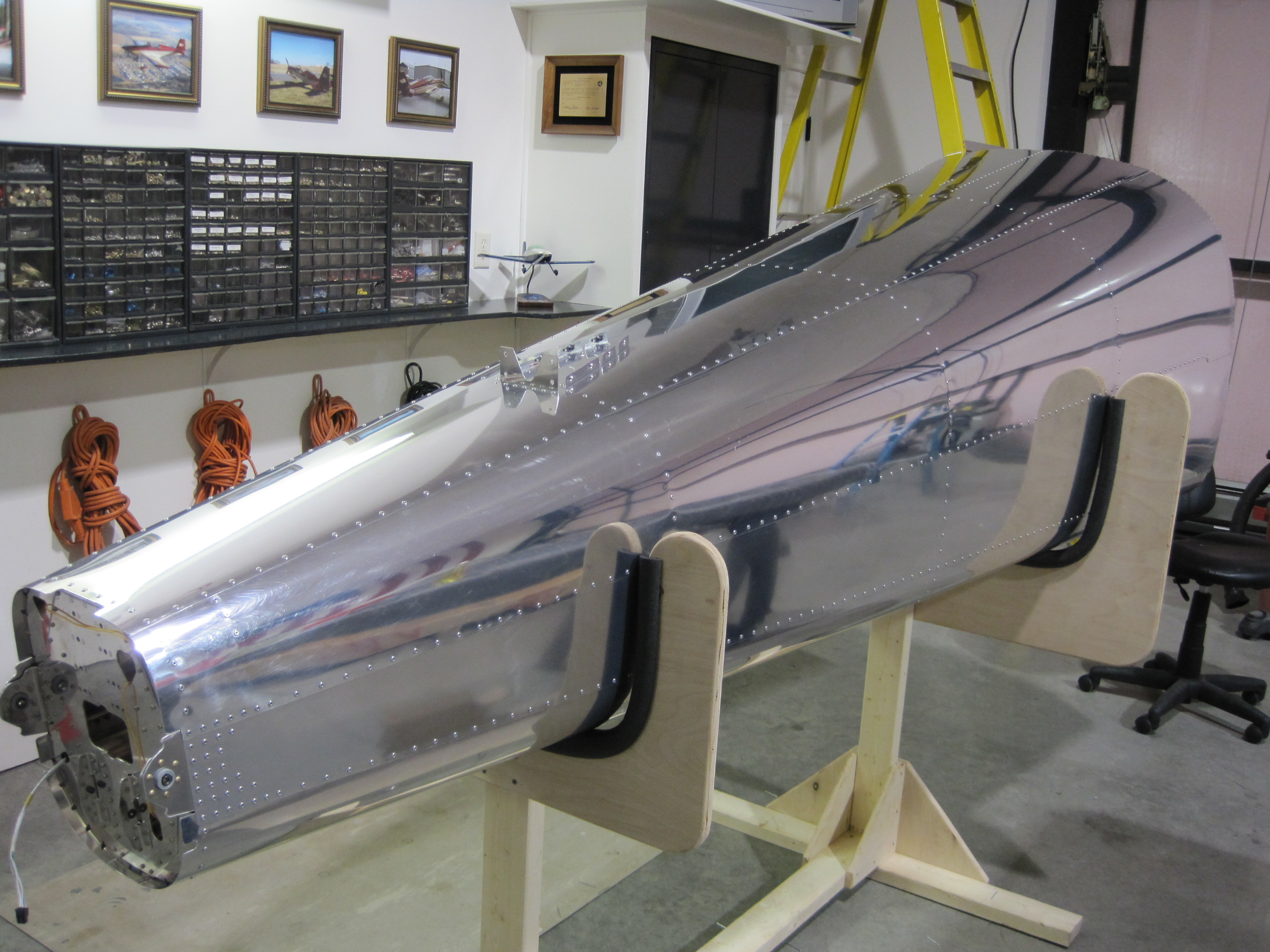

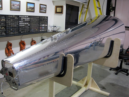

Tail cone Stand
Randy, do you have any hints or plans for constructing the tail cone stand?
I'm about ready to start working on the tail cone and really like the stand in your picture.
I used some plans from this site, from another -12 builder. I wish I could remember his name because I would give him credit. I would give you some measurements but I already disassembled the jig and turned it to ash.
Before you start assembling, trace the outline of the fuselage ribs on some plywood. You can see the rib stations in the picture. I used some pipe insulation to protect the skin. Initially I made the jig lower to the ground to support assembly, but later, I made new uprights and used it to support the tail until the engine was installed.
I'd love to be more specific, but I usually just throw these things together and I don't think that much about it.
