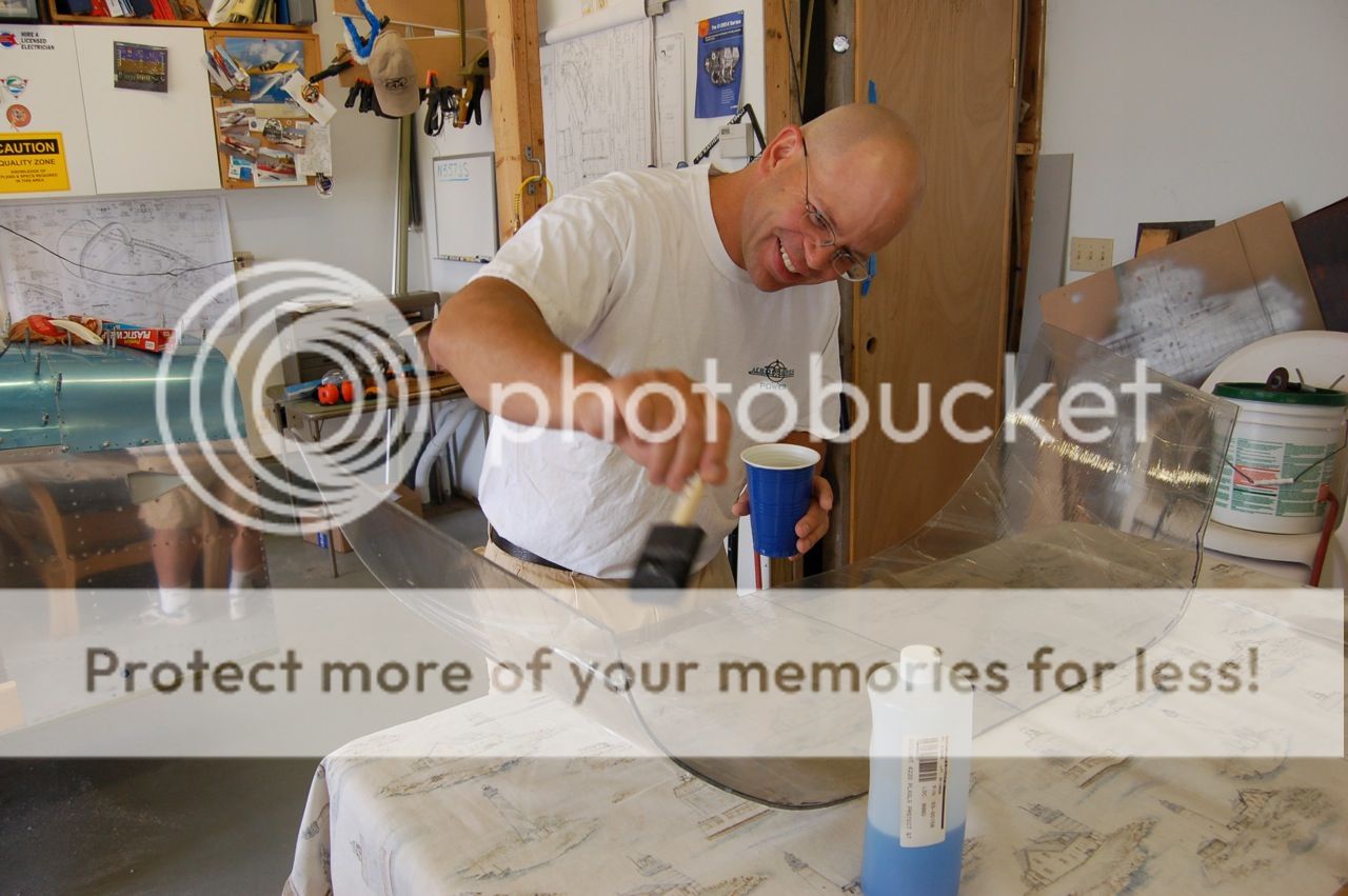

Liquid Plastic
There is a liquid masking film ACS sells it I forgot the item #. I saw the application it's very easy to peel when cured.
Something like this http://www.aero-accessories.com/LMF/LMF-application.html

Spraylat coating
...roger that!
a couple light coats of Spraylat will provide good protection, probably tougher than the plastic.
DO NOT LET THE SUN HIT IT! ( guess how I know this!?!?)
Have used tons of it masking backlit acrylic signs; it seems to 'dry out' over time, so the one year recommendation is good, but more so a heat & humidity thing. ( hot & dry will 'age' it faster)
IF hard to peel off, applying a fresh coat on top will rejuvenate it to some degree and make it much easier to peel.
