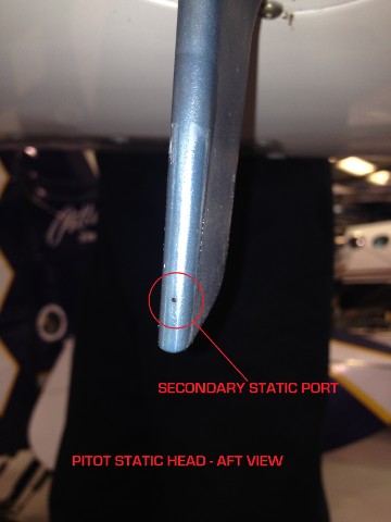

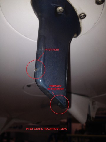

Regarding the PA28 pitot head mounted static port, your comment isn't strictly true. There is a single pitot port on the leading edge but two static ports. One on the lower face of the head, the other, a very small one sited on the trailing edge that is joined internally to the lower one.
Some PA28s such as the PA28-236 Dakota use the same pitot head but the static source is on the rear fuselage.
Pics below of a Diamond DA40-180 we have in on an Annual and that uses the same type of pitot head as a PA28.

Rich, it is in fact as I described it in my photos.
The PA28 (Hershey Bar) Cherokee maintenance manual says:
'Pitot air system consists of a pitot mast located on the underside of the left wing, with its related plumbing. Impact air pressure entering the pitot is transmitted from the pitot inlet through hose and tubing in the wing to the airspeed indicator on the instrument panel......
Static air system consists of a port located on the bottom of the pitot mast....'
The PA28-151/161 Warrior maintenance manual expands on the static system:
'The static air system consists of interconnected static ports on the underside and aft side of the (pitot) static mast. The ports are connected to the airspeed indicator, altimeter and vertical speed indicator.....'
I've carried out hundreds of pitot static calibration and leak checks in my time as an aircraft engineer (mechanic) - many of them on Piper style pitot static masts and I know which hole is connected to which!
This is no attempt at point scoring, I merely want to point out that aft facing vent tubes will not be at ambient static pressure and may well adversely affect the float chamber air pressure.
Rotax say don't do it and they probably know best.... ;)
