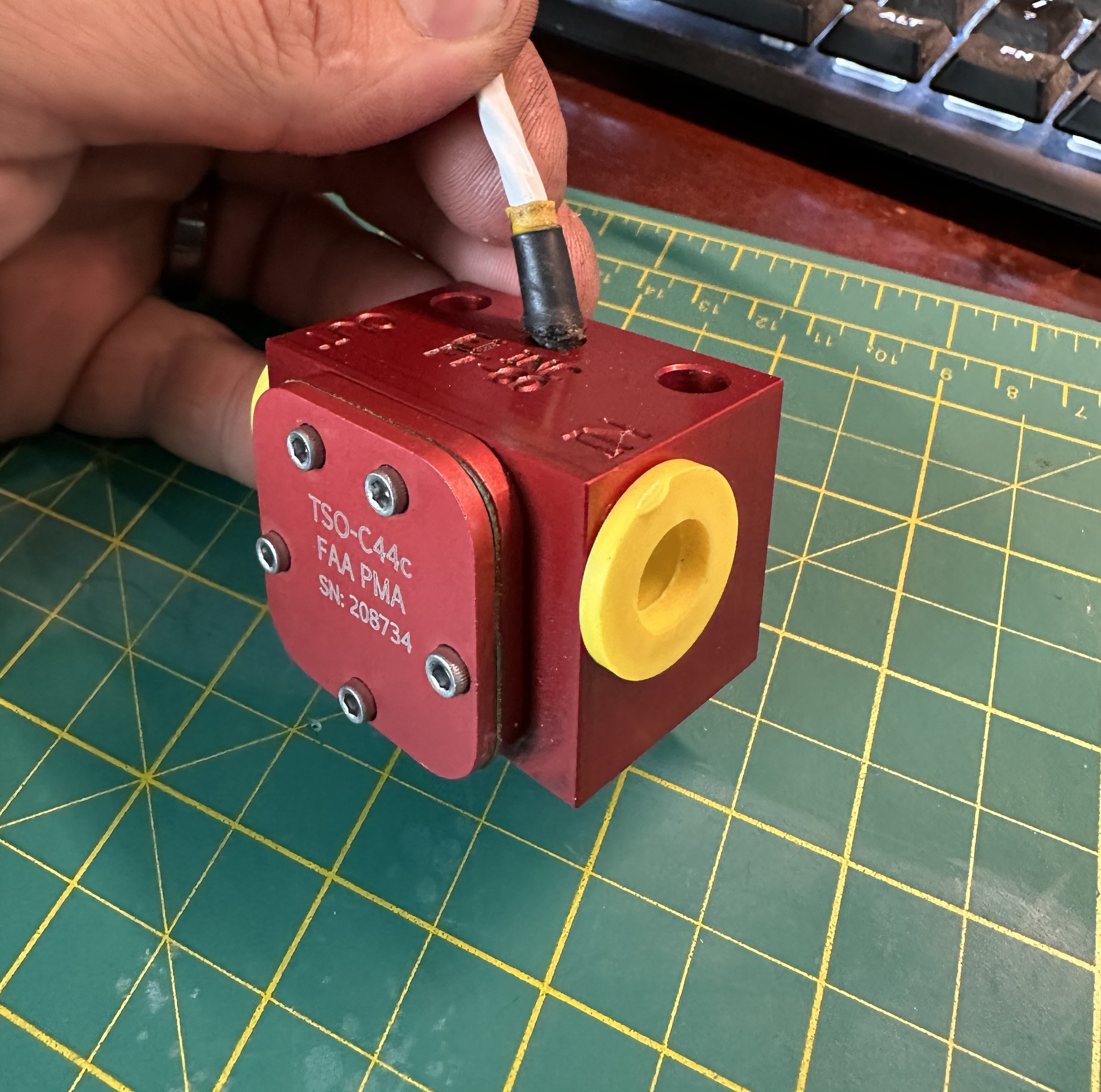

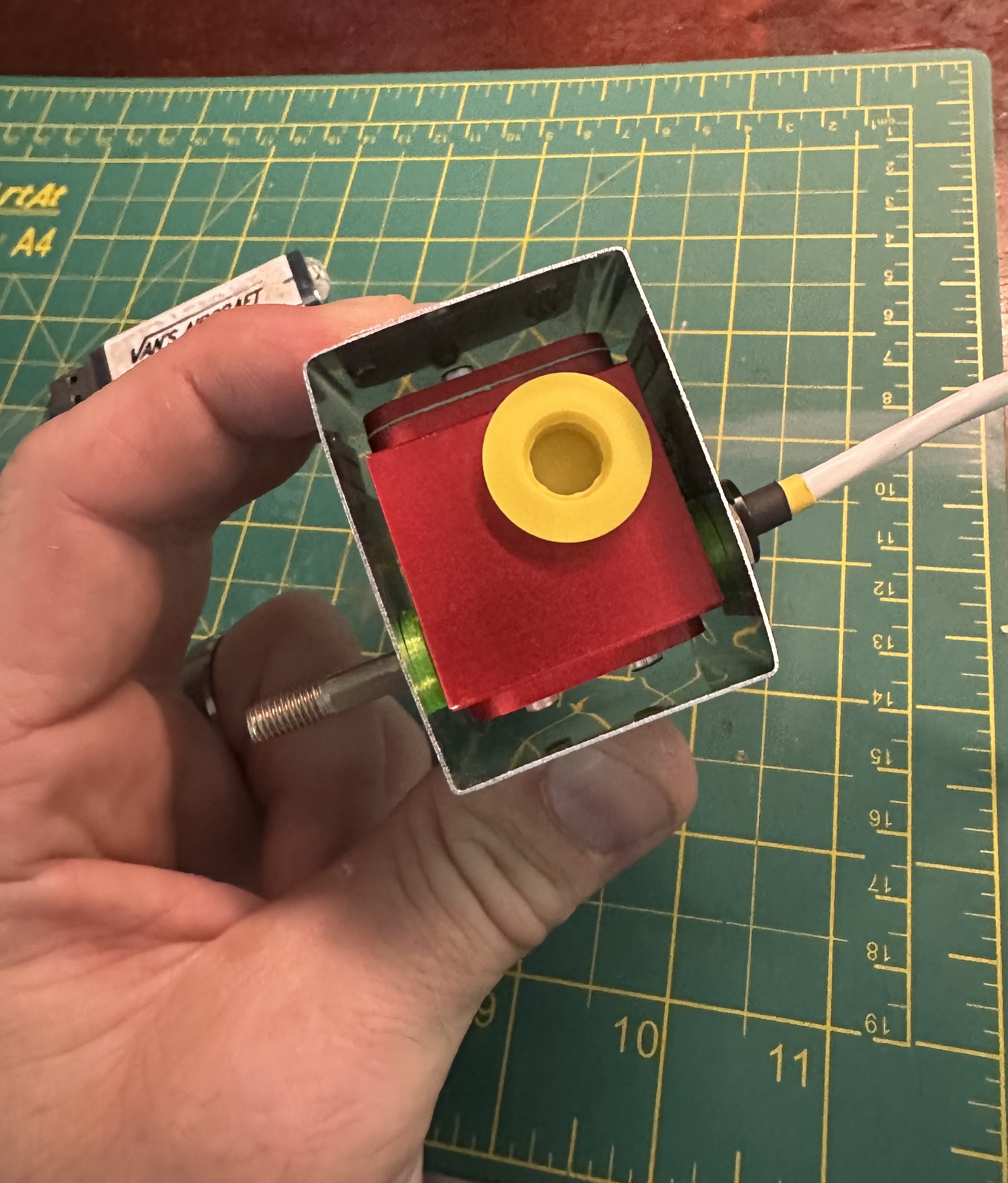

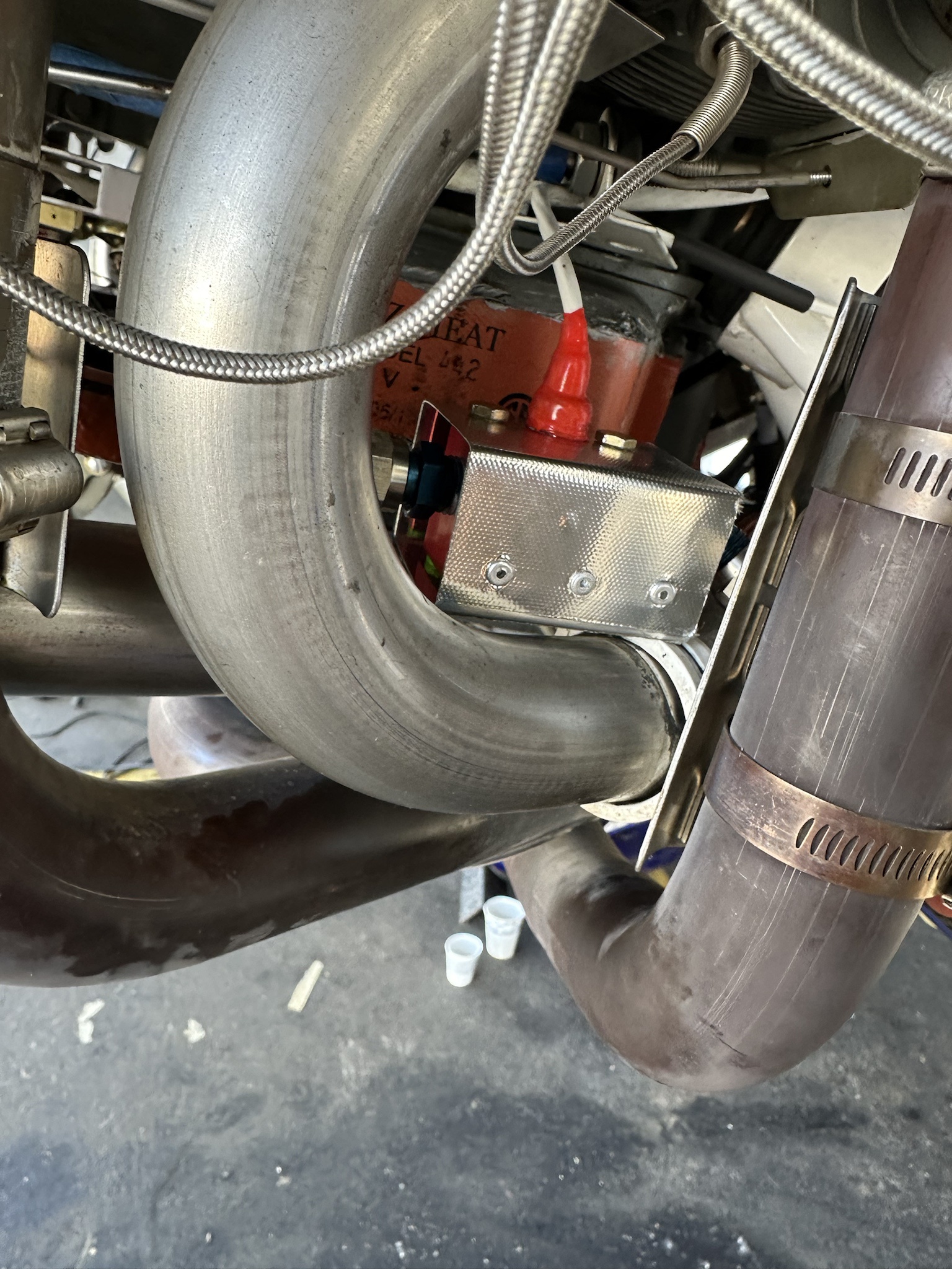

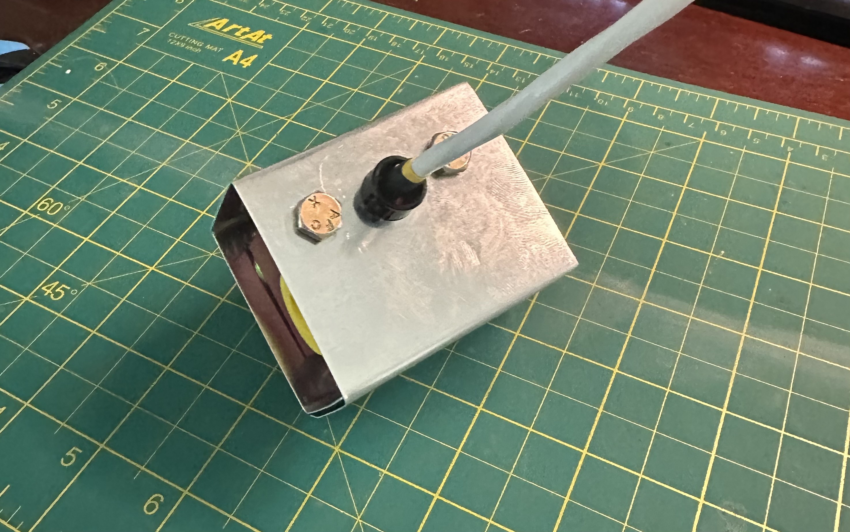

After ~350 hours my red cube gave some erroneous fuel flows varying between 5 and 18 gph on the last flight. It seemed to work properly later in the flight but I assume its at the end of its life. I am trying to figure out how to better protect from heat in the standard RV-14 location on the intake tubes. TS Flightlines has a relocation kit to mount on the engine frame but I was hoping to just swap it out with my existing fuel hoses. I created a heat shield out of scape aluminum but am not really sure if this will help or possibly make it even worse. I was going to put some stick on refective heat shield on top. What is the correct thermo evaluation of my solution?
Add some Shiny tape and I think DanH would approve of this. :)
You do have the two shields already installed on the #2 and #4 exhaust headers...right?

Vic Syracuse's book "Maintenance Handbook for Van's RV Aircraft" has a write up on this. Vic recommends wrapping the Red Cube with heatshield/heat barrier (like those you can buy from Aircraft Spruce).
