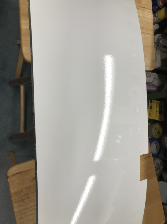

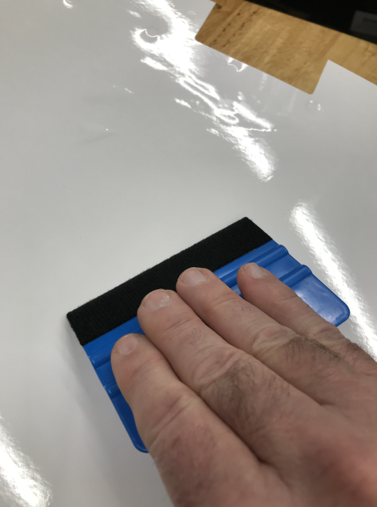

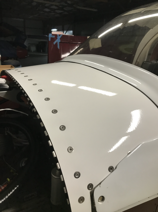

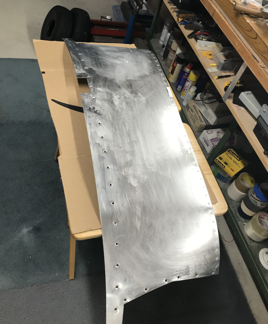

I?m starting my Annual Condition Inspection and needed to access the transponder wiring for ADS-B. While I had the Avionics Bay Cover removed, I decided to strip the paint and apply 3m 2080 Gloss White Vinyl. Easy job ? just take your time. Looks like white gelcoat on a high-end fiberglass boat.

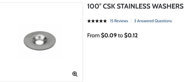

I use Stainless Steel conical washers so flathead screws won?t twist the vinyl on tightening?
