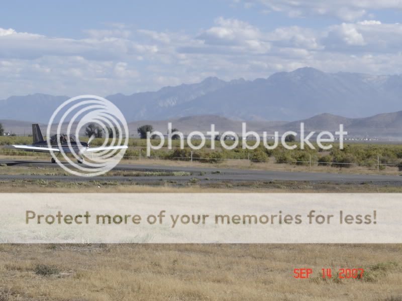

Here's the S-19 landing at WestDesertAirpark(UT99)

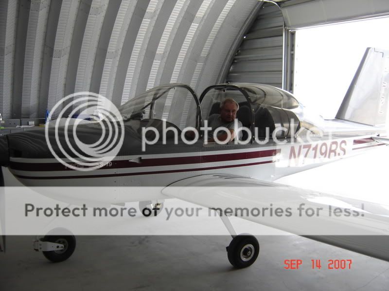

Here's my friend, sitting in the S-19.

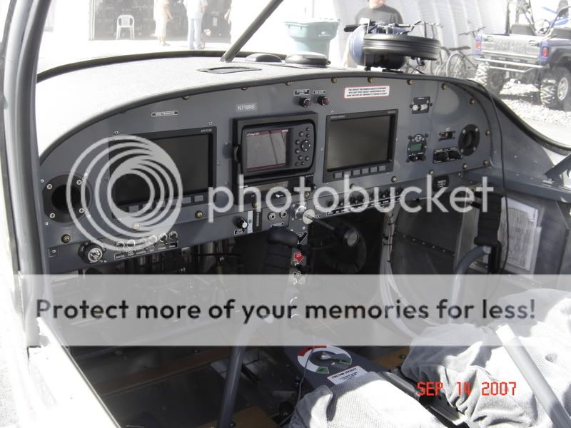

And here is a panel pic.
