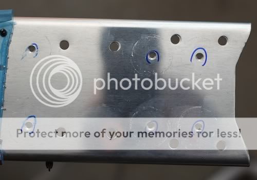

I recently had an issue with match drilling the #12 holes in the VS-1212A-L and VS-1212A-R for the attachment bolts. I'll cut to the end of the story and say that I ordered new parts because I personally did not want to put the parts on my plane as is, regardless of whether they are acceptable.

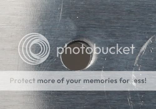

Here are the holes in question, with a close up:
I couldn't find any information regarding what is and is not an acceptable hole. Do holes need to be absolutely matched, or is some level of mismatch acceptable?

You did the right thing, mismatched holes like this are unacceptable when it comes to primary structure.

Thanks for the confirmation, Walt. Given your response I'm even more mystified why Van's didn't respond to my questions on this.

I don't know the particulars of the application, but I've been an engineer for 35 years, and it was always standard practice in the field to drill out bad holes and go to the next larger fastener. That may not have been practical here, but keep it in mind.
Thanks for the suggestion. I actually had considered that, but didn't want to have to change the bolts and nutplates involved. I'd still have an alignment issue with the fuselage bulkhead when it came time to mount the VS because the holes wouldn't be centered anymore. I'd have to drill out the matching fuselage bulkhead holes to the larger size. If I had a problem at that stage, the VS would already be finished so I'd have less options for correcting the mistake. It seemed less risky to just do the VS spar over.

Alex;
As a liaison engineer at Boeing I worked fixes for this type of error a lot.
The engineer at Vans with responsibility for that section of the airframe has all the load data to recommend you ream the hole and install oversize hardware or scrap the part.
You are the final QA on your plane and in my opinion you did the right thing by replacing the parts when you did not get a satisfactory answer.
I recommend you get a copy of FAA Advisory Circular AC 43013-1b /2A
Great reading and it covers your little problem plus lots more.
