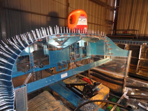

Thanks, Bob, I was pretty sure that was the case but I wanted to be sure since 31Q and 41Q disagreed. I've ordered the F-1083Q to replace the F-1083. Since I'm not using the stock panel and F-1003B, I can easily fabricate an appropriate bracket for the front. In the meantime I can clamp to the temporarily installed F-1003B (the Aerotronics-supplied panel will have the same height as the stock panel plus F-1003B).
I couldn't resist adding a picture of my panel progress. No, really, it's there. It's the clear plastic template that Aerotronics cuts before cutting the final panel. It looks like it goes a bit below the F-1003B (which I'm using as a brace for the bottom of the template) but it is actually even with the bottom flange. As a side note, that clear template looks really cool with the instruments in place. When they did the panel for the -6A, it looked like all the parts were just floating in formation. Sadly, it wouldn't work well as an actual panel - or maybe it's just as well or I'd be sorely tempted to go with the 'Visible Panel' look (like the Revell kits: Visible V-8, Visible Man, etc.).
