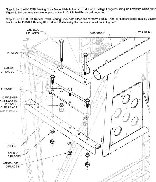

So, I'm exposing my inability to drill straight up while standing on my head with a pan-adapter drill bit...but now that that's out there, I have a question for those who have done this before me.
The F-1093 Rudder Pedal Jig is aligned by the forward holes in the longeron. On the left side, my jig overhangs 1/8" outboard of the longeron; on the right side, 5/16". They should be the same... :-(
Does anyone remember or have a picture of where it should be positioned so that I can drill those twelve rudder pedal attach holes in the correct place? Or alternatively, how much edge distance is there on the aft most hole?
Thanks!
-Jim
