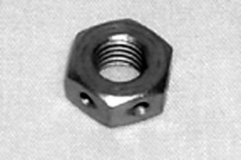

I have been doing my second conditional inspection with 300 hours on the RV-10. I noticed my safety wire was broken on the elevator push/pull tube rod end. I had it installed per plans. I believe the edge of the weldment ear rubbed against the safety wire until it broke. My jam nut did not move as you can see from the torque seal. Recent subject so thought I would share. This is the rod end that can back all the way out if the tube rotates.
