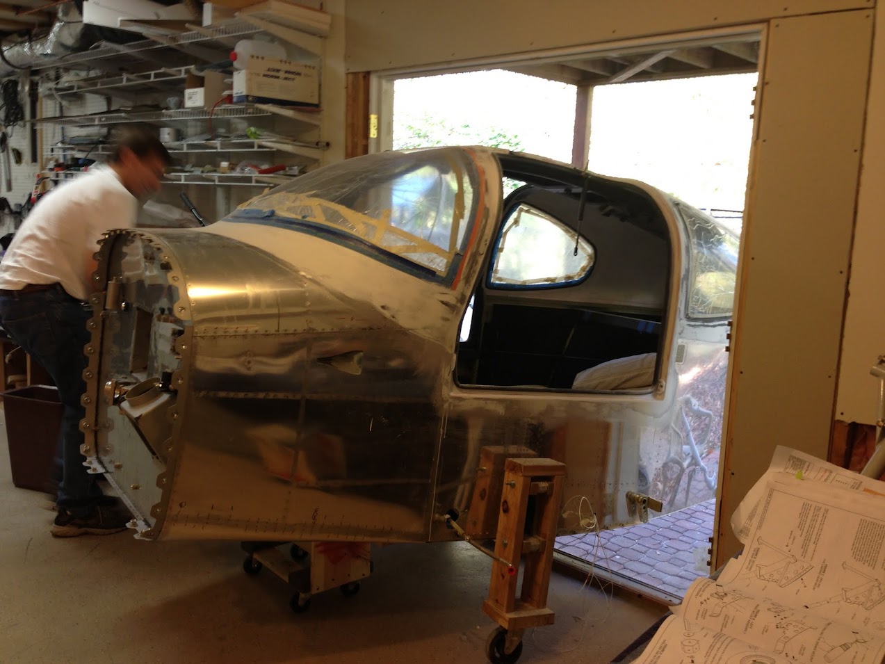

You could easily make a cradle that attaches to the carry through spar to roll the fuse around, no need for installing the main gear until out of the door.
Show Planes had a really nice one that picked up the step socket, and carry through spar when I visited them---------- height adjusts for whatever portion you are working on, really cool feature.
Here is Bill Curtis's cradle http://nerv10.com/wcurtis/fusestand/index.html
Agree with Bill. You will want to have short legs bolted to the fuselage wing spar arms anyway to do all the cabin top work anyway. Leave them on to get the fuselage out the door - put the gear on after that.

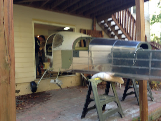

Will fit out of a 6' french doors without the landing gear installed.
Will fit in/out of a 8' garage door with wheelpant brackets installed if you take it out diagonally with dollies under the wheels, at an angle so one comes out at a time.
