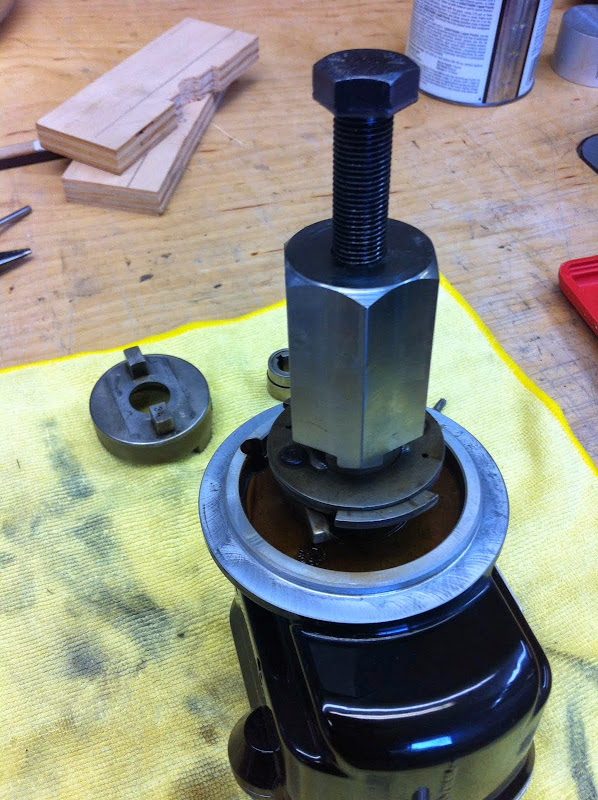

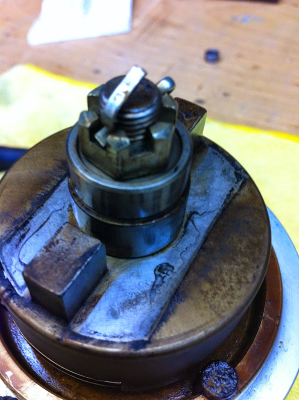

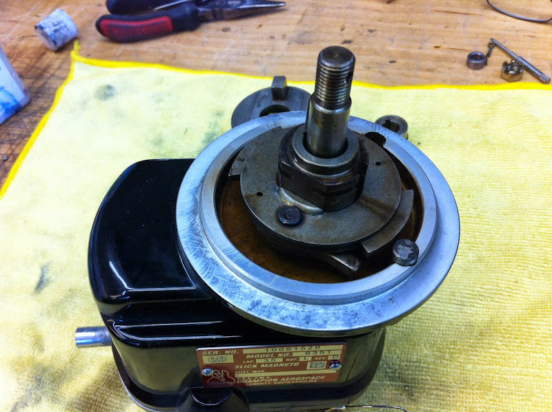

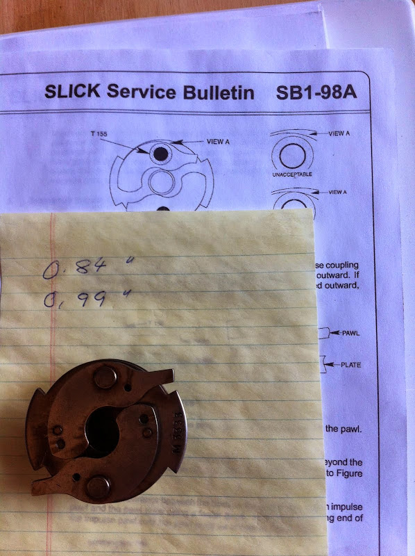

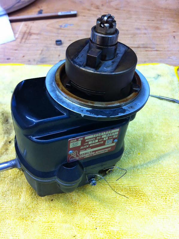

A 250 hour inspection SB1- 98A maybe with the right tools.
Specifically the impulse coupling.
Tools needed: An impulse coupling puller and a rivet gauge.
Maybe this belongs into a different thread but Mr."Slick" Joe Logie was adamant about doing this inspection on affected engines/magneto installation,
saying that he had seen these fail in 300 hours.

Mine showed no noticeable wear around the affected rivets that hold down the pawls. I'll send it in for a 500 hour when it gets there.

The Slick SB and Lycoming SB specifically reference the following engines:
O-540 B2B5, B2C5, E4B5, E4C5, G1A5, G2A5 IO-540 K1A5, K1B5, K1G5
The recommended course of action is a 250 hour inspection.
