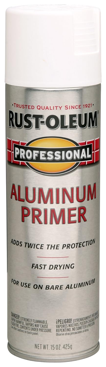

I wanted to use a "shake can" primer (convenient), so I tested 8 different ones.
I sprayed on a clean piece of AL skin (no special treatment or scrubbing, just remove the blue vinyl), let it sit for 3 minutes and did a touch test, so see if it was quick to dry.
After ~10 minutes I did the "fingernail scratch" test, 24 hours later I repeated the scratch test.
The winners are the ones that dried quickly and resisted the fingernail scratch test completely, no scratch.
- The clear winner is SEM PRIMER SELF ETCHING PRIMER (~$20 per can)
- Followed [very] closely by Rust-OLEUM Professional Aluminum Primer (lowest cost)
- Then Majic Fast DRY SELF-ETCHING Primer
All the others (5) did not get close. The winners dried very quickly and resisted the scratch test, no matter how hard I tried!
If someone wants the image of all 8 test candidates, please email me, I will send back.
I hope this helps.
