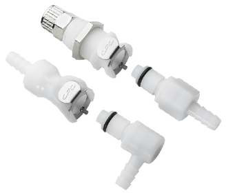

Ja I know, but I need a good interconnect then that will seal decently if you plan to take wings off often. I hope the RV12 wing has inspection hole covers so it can be done ala rv7 style, mounted on the spar flange. From the pictures I've seen so far it doesn't look like it...that will complicate matters a bit. Hence my question where?
Regards
Rudi
what about a fuel line connection (both parts) for a Johnson outboard moter. THey seal well, and are easy to take apart.

The outboard connecter is a good solution. But use a suzuki connecter instead because it's smaller,lighter,lasts better, and is cheaper!
Just use a short piece of shrink tubing to safe tie it. But don't burn the hanger down shrinking it.

Colder Products makes a line of reliable inexpensive disconnect fittings.
