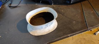

This ^^^^ is what I have done. I started by laying-up 4 plies in the inside of each inlet to make thin "rings". Then, I made rubber boots that slip over the rings, covering about half the length of each ring and secured with hose clamps. Next, each cowl inlet was shortened 3/4" to provide clearance for the boot & clamp. I faired the inlet surfaces with some micro so that the rings are not noticeable when looking into the inlets, although not really necessary. Now, I can remove the top cowl with the inlet rings and rubber boots remaining attached to the bottom cowl.

Here are a few pics of the parts during the build process. However, I do not have pics of the rubber boots or the finished product and I do not plan to visit the hangar for a few weeks...
The rings are 1/16" thick, so the inlet size is slightly reduced. Also, the rings are somewhat flimsy until they are installed between the upper & lower cowl. Once installed, the rings become very stiff.
When installed, the rings are trapped by the micro fairing (fwd movement) and the inlet draft angle (aft movement). I added a couple of screws to affix the rings to the lower cowl as an added measure of security.
