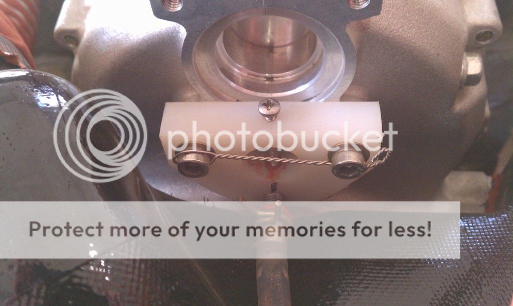

About a week ago I notice that my pitot tube would move horizontally about a qtr inch every time I put the cover on it. I would pull it back and it would stay there. I assumed the set screw needed tightening. Today I took on that small task. I was wrong to assume of course.
What had happened was the entire white plastic pitot block had moved away from the gearbox backing. The pitot tube and set screw were still in tact. The safety wire between the two 6mm cap screws was still in tact. What no longer existed were the threads on the aluminum gearbox that the cap screws turned into. The cap screws were not out of the holes, they were just floating there. Nothing left the aircraft of course because the pitot tube/block set-up hadn't changed and the retainer cap screws were wired together.
Now I have to decide how to re-attach the cap screws. The original plans tell you to mount the pitot block and thread the cap screws with appropriate washers in place...turn until they touch the surface of the washer...then turn another qtr turn...safety wire. I gathered at the time they were concerned about too much torque against the plastic. Apparently they just vibrated their little ***** off until they ate up the aluminum. So I see the following options:

Here is what it looks like:
There are two more tapped holes above the two securing the FF-1201 Pitot Block. If the bottom two tapped holes are deep enough then you could use the M6X35 you suggest. But, even better would be to make a larger FF-1201 Pitot Block and use all four of the holes to bolt it to the gear case. I also think that low strength Loctite #220 would be wise also to keep the bolts from vibrating in the threads.
Just my initial thoughts, sounds like a problem easy to fix. There may be even better solutions offered.
Tony

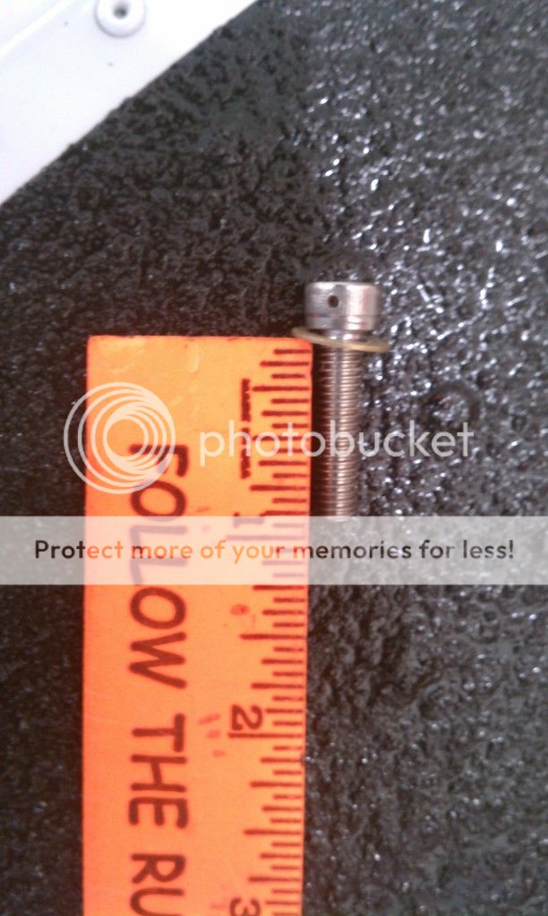

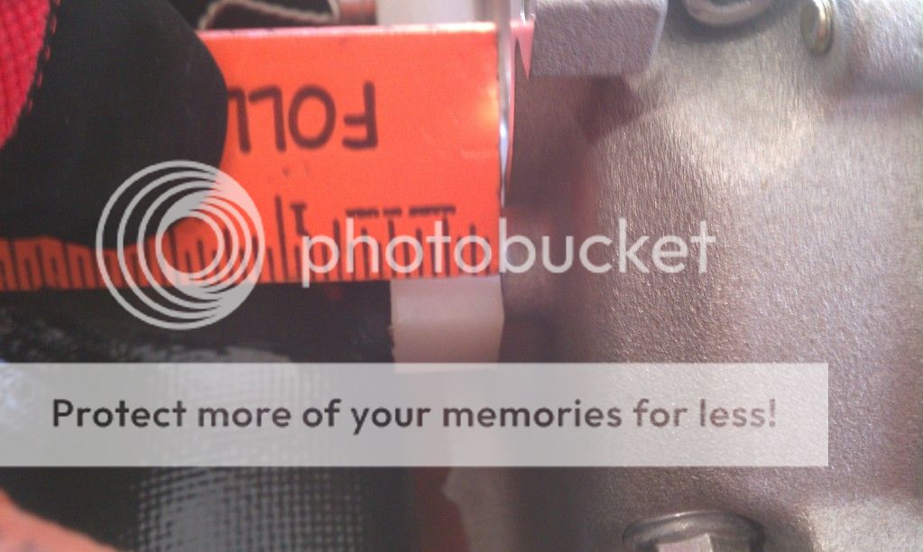

Just checked my today. Both bolts still snug.
However the bolts are only 1 inch long and the block is 1/2 inch thick.
Not very much thread in that hole so I went ahead and took the initiative, removed both bolts, put blue loctite on them then reinstalled them. When I removed them they were still snug but not tight. Now I don't have to worry about if I miss checking them next time I have the top cowl off. I believe that's called peace of mind. ;)
