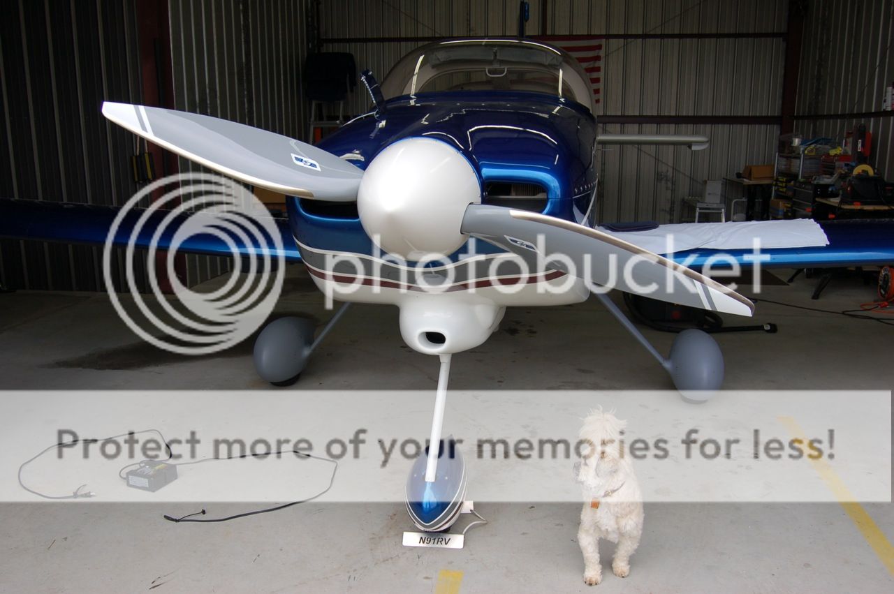

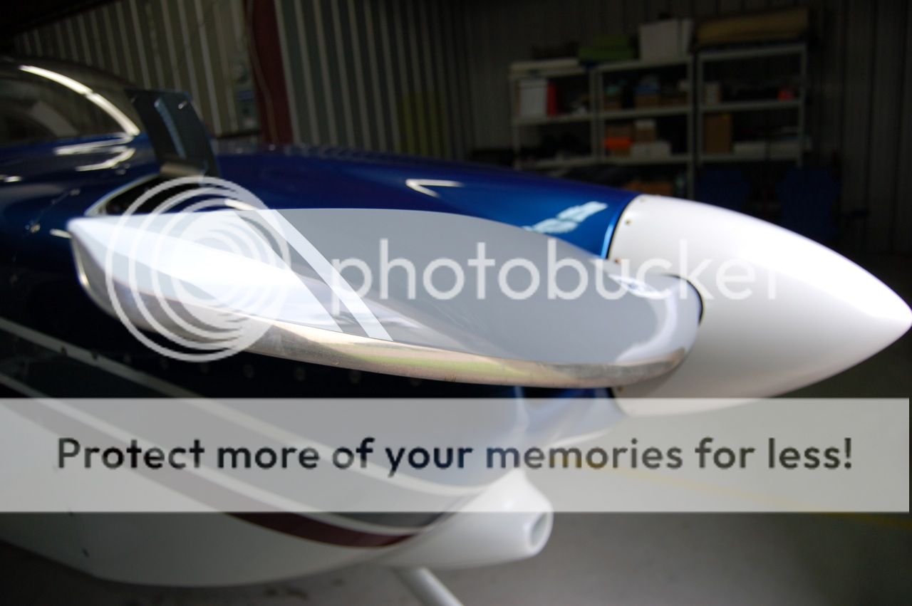

Installation was not without some issues, all easily surmountable/avoidable. The WW 200GA is comprised of the following components: 2 composite blades, billet alum hub assembly, composite backplate, 'front plate' and spinner, all mounting hardware. A 2.25" spacer is also required (sold separately). The WW 200GA arrived in beautiful condition - I had them paint it gray (I'll try and post some pictures very soon). I also purchased the WW spinner - also a very nice product - no trimming, just paint and screw on.

Once all new bushings were in place the installation went quickly and smoothly using the new bolts. The last challenge was to set the proper pitch of the blades. Clearly an indexed GA hub would be easier, however the WW hubs gives you the ability to make very minute pitch adjustments. A good digital protractor is essential. With a little finese, I was able to get the blades pitched to within 0.1 degree of each other (spec is 0.2deg). I started at 19.5 deg pitch. I found it much more accurate to set pitch while blades are leveled at the 9o'clock/3o'clock - pitch one blade, then rotate 180 deg, re-level and pitch the second blade.
After installing spinner I did a run-up - 2200 rpm static. I then took it up for a short flight - prop readily approached redline. I landed and repitched to 20deg. which resulted in a static of 2150 rpm. I have flown 4 hours at this pitch setting. Performance has been great all around - great climb and better cruise then with the Sensenich. I may want to pitch an additional .25-.50 deg at some point to give me better performance at cruise 8,000'-10,000'.
