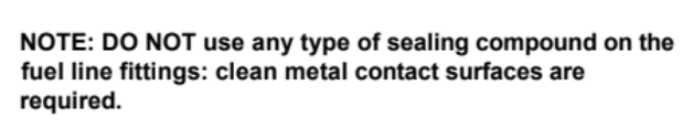

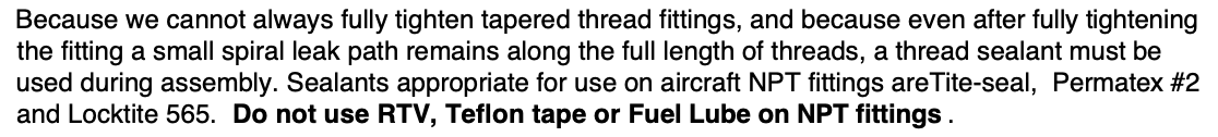

Resurrecting this thread because I see two different recommendations from Vans regarding sealing fuel line fittings.
In section 5.27 of the plans (Fluid Fittings) it says this:
On page 31-08 of the RV-14 plans (fuel system) it says this:
What am I missing here?????

Tapered NPT threads on fittings need sealant. The threads on nuts for flared fittings or the flares themselves do not, their seal occurs at the flare not the nut. The flares themselves need to be clean and dry.
Thanks for the reply Sam. As you can tell, plumbing is one of my weaknesses.
Just to be clear so I don't have fuel spraying all over the place the first time I energize the pump, the fuel lines in the RV-14 are flared fittings, correct? If so, where are the tapered NPT fluid fittings used that are referred to in section 5.27?
Here is a pic of a typical pipe fitting elbow. The sealant goes on the NPT threads that are on the right hand side. Only a small amount of sealant, all the way around, and not on the first two threads.
The left hand side of the fitting doesn't receive any sealant on the threads or on the tapered end for the flared tube, since it is all installed dry.

VAF members: glad I found this thread. Recently had a situation where an A&P was requested to troubleshoot a 912is for fuel pump issues. Unfortunately the issue was not the pump assembly but the A&P itself. We found thread sealant contamination inside fuel valve pressure (white-ish gummy residue mixed with AVGAS) after engine stutter and plenty of gunk around the IN and OUT fuel lines. So we believe the sealant was utilized were it was not supposed to. What type of sealant will leave such white-ish residue when mixed with 100LL ?
