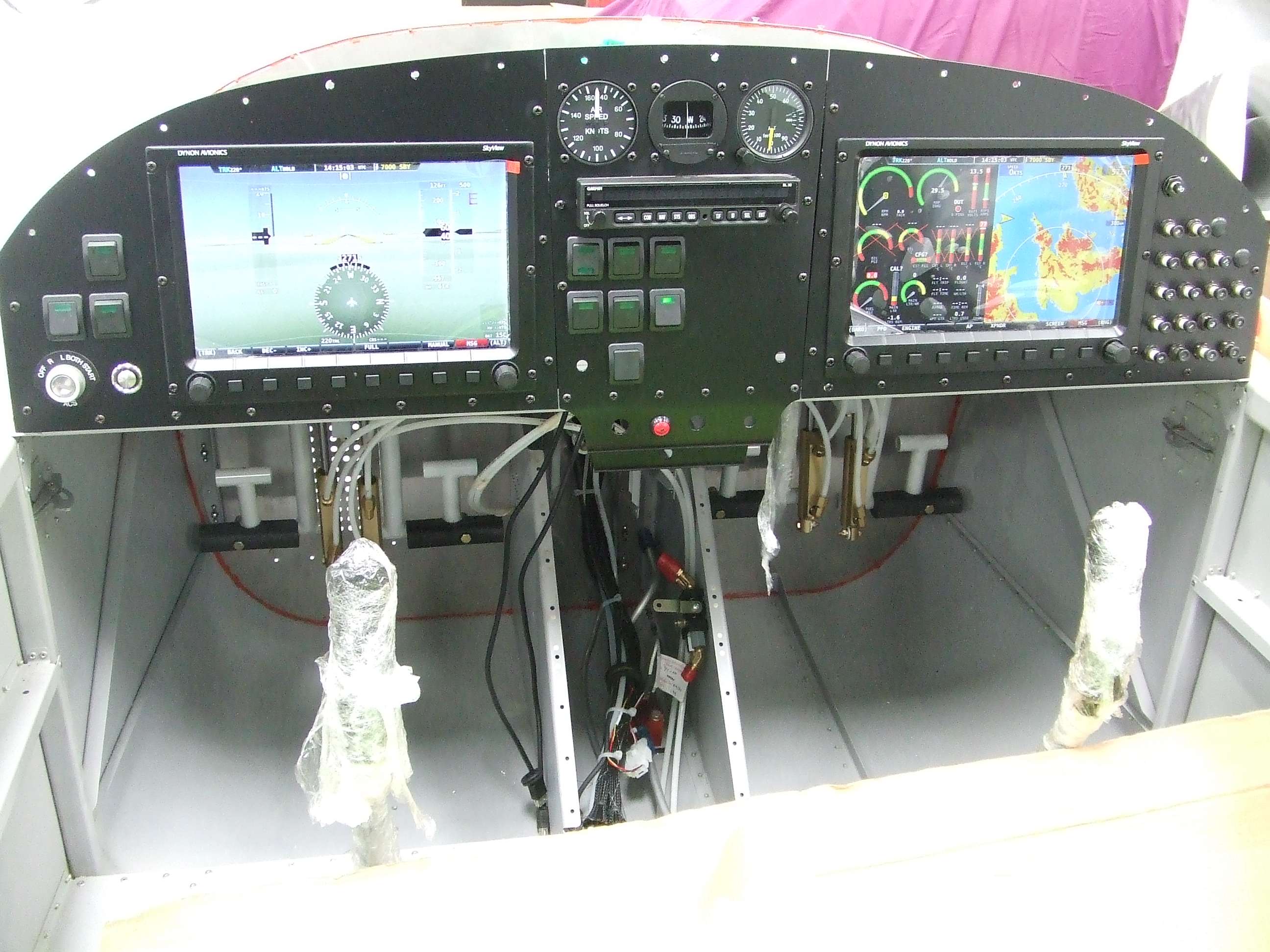

With apologies for a poor quality photo but it shows you what can be done with two 10" SkyViews and an RV-12 panel - and before you ask, the standby ASI, alt and compass are a UK requirement.

I count 20 circuit breakers. What is there a need for 20?
I am no where near your stage so I don't doubt it is the correct number for your panel.

I think two may not be circuit brakers?
maybe lights?

There are 18 plus two grommets ('just in case' holes). They are for:
1. Main power
2. Nav (SL30)
3. Com (SL30)
4. Txpdr (SkyView)
5. Nav/strones
6. Land light
7. Interior flood light
8. Headset power
9. Power socket
10. Alternator
11. Starter
12. Auto pilot
13. Fuel pump
14. Pitch trim
15. Stall warner
16. SkyView P1
17. SkyView P2
18. Intercom
My estimate for total power consumption (based on all the figures I could find) is 19A - but that's all the lights on, autopilot operating, backup battery charging, transponder transponding etc - not a very likely scenario.
A more normal consumption should be under 10A. Time will tell if I'm right or fitting the aux alternator...!
Incidentally, the belt driven fron mounted alternator is an official Rotax option (40A). Our Tecnam P2006T has a pair of them, it's an option on the Tecnam Sierra (good if night flying) - they don't use LED lights which make a huge difference to the consumption figures..
The only thing that is till confusing the **** out of us is getting the battery master and avionics master switch LEDs to light up when you want them to light up (ie when 'on'). Very strange, tried everything but they don't work well when controlling solenoids'relays, it would appear!

The switch that separates the nav lights from the strobe lights will require another wire be run to the wingtip. The existing lights common those individual wires on the tip light and feed them from one wire. One wing has a spare terminal, the other does not. Even after installing the tip lights, I left in a pull string. But I am not sure I want this feature enough to pull another wire and mount another terminal on one wing.
Bill, that's exactly what I thought when looking at that switch. Do I really want to take the nav light fairings off to pull another wire through and get this feature? I thought about how often I ever used this feature with my flying RANS S-12S which has split switches for nav and strobes. The answer was: never. I think the only time it would be making a difference is when flying at night. You wouldn't want to ruin the night vision of other pilot while n the ground. I'm a sport pilot, I don't do night flying.
Nav/Strobe
Pulling the wire in the wings is only part of it. An additional two wires will have to be pulled into the main fuselage bundle, up over the pedals into the instrument bay.
I would never have much need to run with just the nav lights on either, but if I were getting the new panel I would want all the switch positions functional. I just can't stand to have "inop" switches.
Tony
I will probably wire the switch so that either position works both the strobes and the navs. Presumably there is a "both off" position in the center. The only reasons for separating them are courtesy at the ramp (no strobes then, lights OK) - but you could just wait until taxi-out to activate both, and cloud reflections in night IMC. And you could just turn both off temporarily for that. (A cautionary response with appropriate FAR reference expected next...)

You did leave out one good reason, which is formation flying early and late in the day when lights are a good idea (or required by rule) strobes (his or yours) are not a good idea when trying to concentrate on your lead-man.

Just flying around in the daytime, I generally leave the nav lights off since they don't show up well. But the strobes do, and I always fly with them on.

I think you would only have to add one wire for the strobs to the panel and if you run a ground for the interial light back like the plan calls for to the main panel you could ground the light and use that wire for the strobs.
