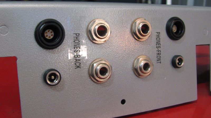

Square holes are easy
First, do like Ray said and make a paper template. Cut out the hole in the paper. Then mark your panel with a fine sharpie. Use round drills to make the hole as large as you can without going over the lines.
Next, I bought an inexpensive set of needle files. Some are round, 3-sided, square, flat, or curved, etc. Just file to the line and check for fit. It didn't take me long to get mine finished, seen here with round holes for traditional jacks. I'll be able to use both.
More photos and discussion on my web page, here:

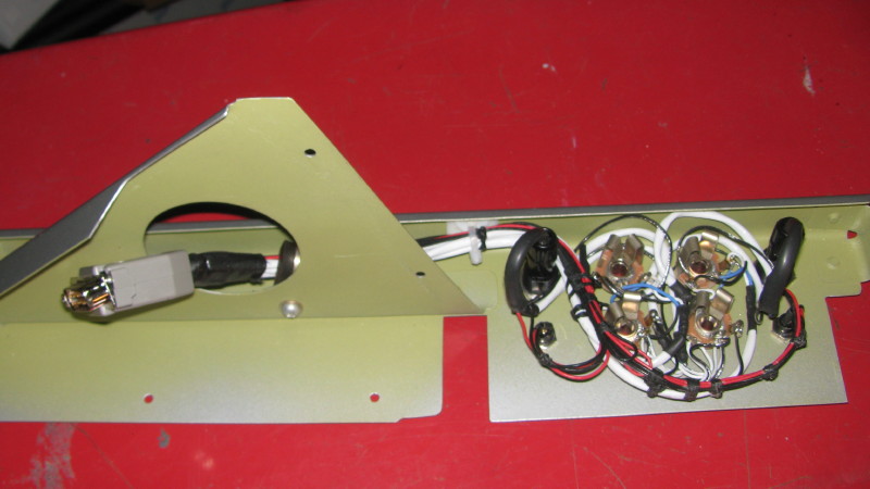

Headset Jacks
I also added a 10 Volt power jack so I could use Headsets, Inc type ANR headsets. 10 V is shared with Lemo jack. Why 10 V? It's the minimum to power the Bose/Lightspeed headsets and the maximum for the Headsets, Inc.
