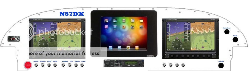

You can use any of the CAD applications. I started with Autocad, but ended up using Visio because I found it easier to use.
If you are planning on using any of Aerosport Products panels, yo u get get the dxf files from Geoff.
I then superimposed actual bitmaps to produce a picture to share with friends.
You then can use the cad file to send to a cnc machine, water jet, or laser to cut your panels.
I also will use a version of the same cad file to produce panel labels. I haven't decided whether or not I'll use transfer decals or paint.
As you can see there are more than one way to do these tasks.
Bob

I just wanted a rough scale of the design to "drag and drop" the avionics/instruments into place and rearange them on the panel.
I used google skechup which is free. it will not open a .dfx file though from Geoff so I just imported the panel as a picture and drew an outline of the inserts in skechup then removed the "background" imported picture to leave the outline.
Then scaled the outline to size.
Then imorted pictures from the web of avionics that i was interested in and scaled them to size.
After that just drag and drop till you like it.
Keep in mind this is not good enough for sending out to you panel cutter/labeler. It is only for getting the "look" you like. I opted to do my own cutouts and labeling.
Have fun!

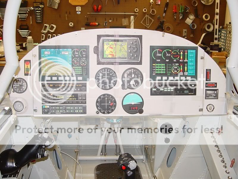

I did it the low tech way. To start with, I drew ref lines on the panel blank that comes with the kit. I then printed out accurate life-sized pictures of all my desired components and placed them on the instrument panel. Once I had things layed out the way I wanted, I verfied that everything was clear of the sub-structure and identifed where I'd need to cut the sub-panel for the radio stack. When I was finally satisfied with the layout, I used a combination of templates and dimensions available in the install docs to identify the cutouts. I then went at it with a Dremel and cut everything undersized, and then filed out to final size.
Well, guess I gotta stick up for the low tech folks.

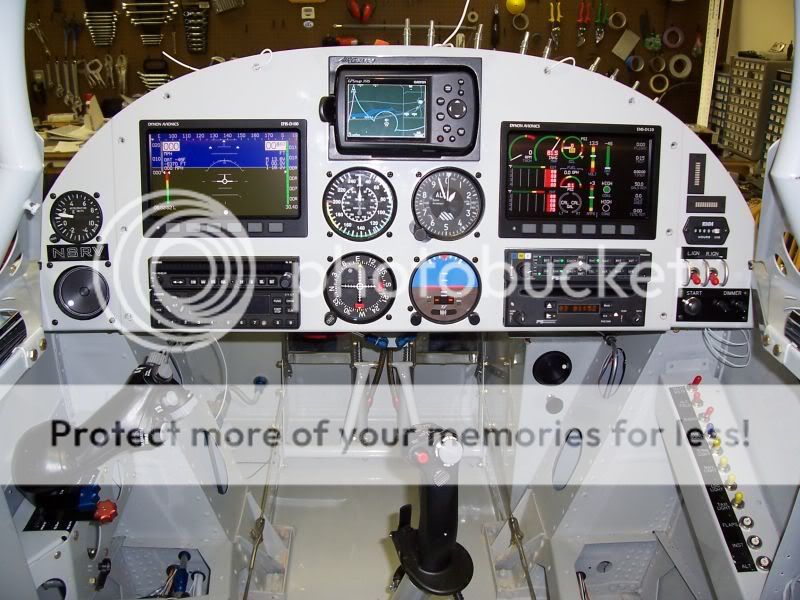

I cut out pieces of paper the correct size for all the goodies I wanted in my panel, labeled them with a pencil, and taped them in place on the panel blank, then sat in the plane and "flew" it while I worked out the fine details and sorted out the final location.
Lots of work with a drill, die grinder, coping saw, and file later, and I am quite happy with the result.
Here is the first power up.

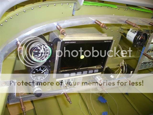

I love the "glass panel" look. I went the low-tech way too, after I tried one of the computer-based panel planning programs. My solution was to cut a panel out of thin Masonite and install all my gauges, switches, EFIS, etc. This also allows you to see how everything fits in back, which my panel planning software did not do. It must have worked, because when I was satisfied with the layout, I cut the aluminum panel and so far I'm happy flying with it.

You could also use a piece of clear acrylic plastic from Home Depot. Cut the holes with a fly cutter or Dremel and add parts to check for a rough fit.
This is good to get the 3D clearance behind the panel. Then you get your own true "glass panel"...:)
Gill,
Seeing this makes me think about making my panel from plexi permanently. Of course, it makes it a lot more important to make the wiring and plumbing pretty.
