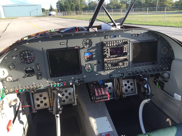

First, the before pictures:

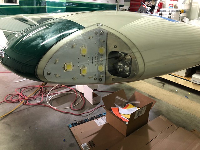

Upgraded LED lighting:
- FlyLEDs for Nav and strobes
- Baja squadron pros in the wingtips for landing / taxi lights

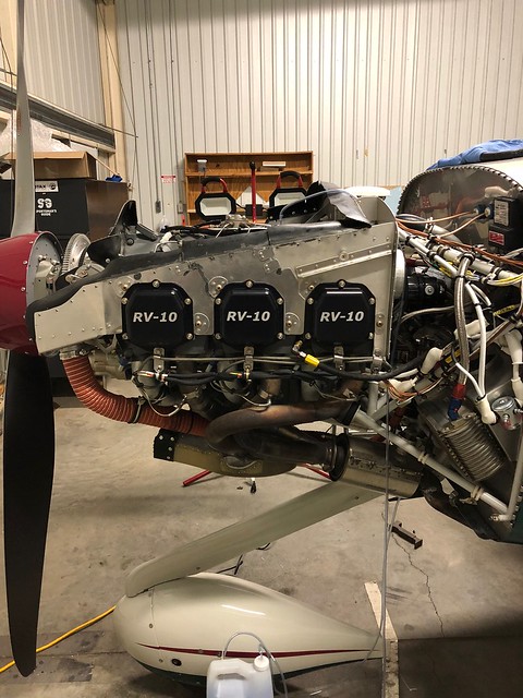

SDS valve covers:

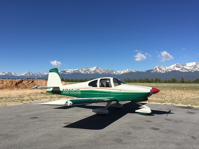

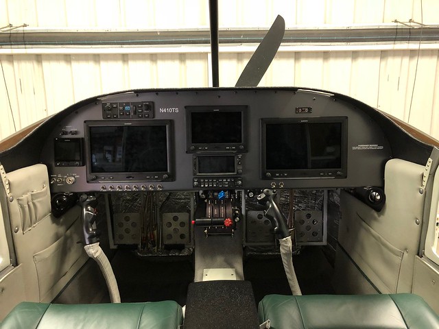

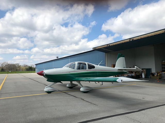

The finished airplane and panel:
I used Bill at Up North Aviation for panel layout and cutting; he was very patient through MULTIPLE iterations of the panel layout, and very quick to respond with an updated file whenever I sent back requests and changes. The final product was exactly what I wanted, and everything fit perfectly.
Danny at SteinAir did the layout for labeling etc, and handled getting the panel painted, laser etched, and backfilled. He was also very patient, and did a phenomenal job with layout. The finished panel looks great, and is very durable.

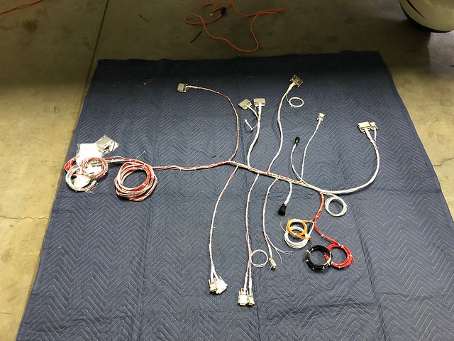

Tim Hass at Approach Fast Stack and his guys did an unbelievable job with the wiring harnesses. Once we had everything laid out, we pulled scrap wire between the LRUs and sent him lengths (he has a worksheet for this which makes it very easy). The harnesses were all perfect, the CAN bus functions flawlessly, everything is clearly labeled, and they included detailed wiring diagrams for all of the interconnections and devices. I could not be happier with the process and the product, and Tim was always very helpful with my questions and with layout and connections for the system.
Paul at FlyLEDs has a great product, and great support. Highly recommended, the lights are lightweight, bright, and easy to build / install.
![28529844508_521dcd37c9_z.jpg](/proxy.php?image=https%3A%2F%2Fc2.staticflickr.com%2F2%2F1728%2F28529844508_521dcd37c9_z.jpg&hash=755bc1d5b72d69290c103af991fa1fad)
![28529865708_8f2d7f92aa_z.jpg](/proxy.php?image=https%3A%2F%2Fc2.staticflickr.com%2F2%2F1733%2F28529865708_8f2d7f92aa_z.jpg&hash=22762f0128e3c61d343e1fdb0cc12efd)

SDS valve covers:
![28168271737_aff877a9f2_z.jpg](/proxy.php?image=https%3A%2F%2Fc1.staticflickr.com%2F1%2F923%2F28168271737_aff877a9f2_z.jpg&hash=9dc24c7ba40fe94dcfba121c69539171)
![28168243077_a9d4a8679a_z.jpg](/proxy.php?image=https%3A%2F%2Fc2.staticflickr.com%2F2%2F1822%2F28168243077_a9d4a8679a_z.jpg&hash=b5bbdb5bcbb49e938c94c7e139085eba)
![29165018438_26b5bf48eb_z.jpg](/proxy.php?image=https%3A%2F%2Fc2.staticflickr.com%2F2%2F1762%2F29165018438_26b5bf48eb_z.jpg&hash=d705af4044552c0ccec25fa935701aed)
![43037102321_327bea879f_z.jpg](/proxy.php?image=https%3A%2F%2Fc1.staticflickr.com%2F1%2F924%2F43037102321_327bea879f_z.jpg&hash=9e05ae66ca3a4fc1e0b24dc34db9ea6b)
![39523227515_a5227c79cf_z.jpg](/proxy.php?image=https%3A%2F%2Fc1.staticflickr.com%2F5%2F4762%2F39523227515_a5227c79cf_z.jpg&hash=7e23ab9a3dbf91eea9c7fcbfa5e5edfd)
