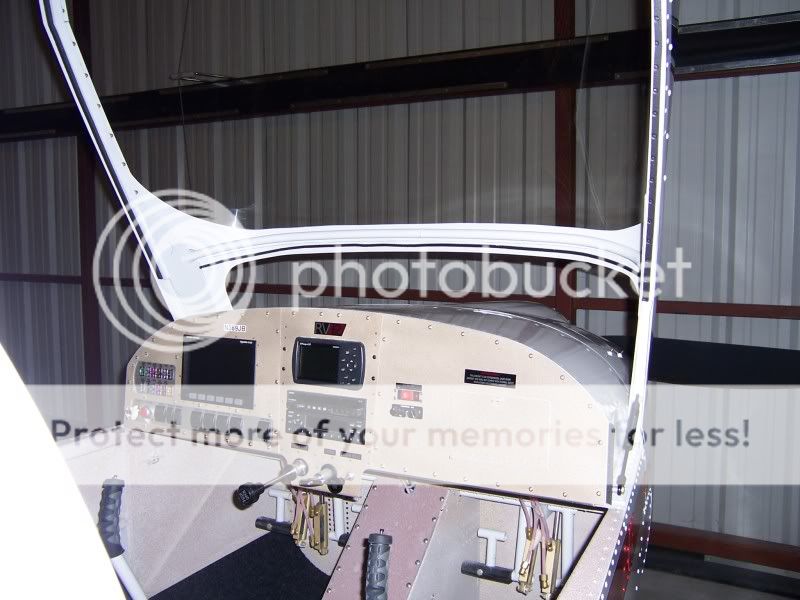

I want to paint the portion of the canopy that is directly under the f/g lay-up. Looking for advice on prepping the plexi to accept primer and paint? Thanks in advance.
What I did - -
I sanded it with 400 wet/dry paper. Used a flat white primer. It has stayed near perfect. As the picture shows, I painted the entire inside of the canopy frame the same white primer color. Happy with it.
