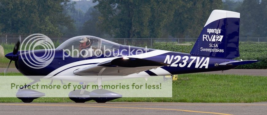

I am looking for the Paint Codes for this dark blue,can anybody point me in the right direction?
PaulR
Have you tried Synergy Air in Eugene?
They built the airplane and had it painted in Eugene Or.
Its called Tahoe Blue.
Paul,
Here is the information I received from Gus at Van's concerning the paint colors of the blue SLSA:
Below are the paint codes for each color. The white base coat is just
white toner and the white pearl is a custom mix so there are no
automotive codes available. I have included the toner formula for the
custom white pearl and the toner number for the white base. The
product line used is Sikkens Autobase Plus and Sikkens Autoclear III.
Sealer: Colorbuild Plus Bright White CBP002
White Base: Q120 (White Toner)
White Pearl: Custom Mix (Q070 - 188g; Q911M - 29.5g; Q911H 1g; Q065 -
173g)
Silver Pin: VWLA7W(L), Lighter
Blue Pearl: SUZM9075
