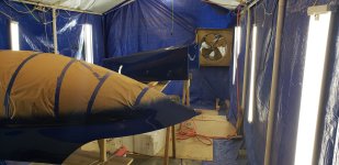

The booth was built in my hangar. It worked very well but was no where near big enough to fit the plane in with wings attached (nor would I want to). I found the bottom of the fuselage to be the biggest PITA, so I can only imagine how bad painting the bottom of the wings while still on the fuselage would be. With the wings off it is easy to flip them around between two tall saw horses to paint each side.

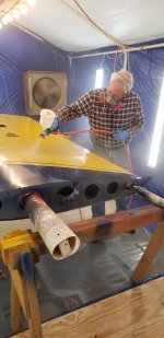

I am cheap so I pained the entire airplane in the backyard and the driveway before trucking the pieces to the airport. I wasn’t planning to hire a pro so it was an easy choice for me. I see a lot of bare aluminum RV that flew to the Corona paint shop after they were done with their phase 1 .

Painted before engine run with wings off and everything apart. Fuselage and each wing on separate rotisserie made very easy to paint in a small home made booth in my hangar. Prep was simple, parts clean when primed/painted, and never worried that I might need to change something that would mess up the paint, and never had too.
I would do it exactly the same if/when I build again.

I painted everything before flying. I built a paint booth and filtered the incoming air and then used paint booth filter material to catch the overspray. One blower was used to pressurize the booth and a second, explosion-proof blower was used to exhaust the paint fumes.

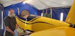

Just finished my 9A, so here's a data point.
It took me 14 months to build the plane. I enjoyed every minute of it.
I decided to paint it myself. It took me 4 months to paint it. (Before final assembly) I can't say that I enjoyed it, but I learned a lot and am very happy with how it turned out. Painting is a LOT of work.

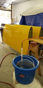

Carl what is the bucket and tube.... is that cooling your shop air?

That is an air dehydrator. Air (after the inline filters and drains) goes in the top of the coil. The bucket is filled with water and a couple of milk carton blocks of ice. Water in the air plates out in the coil and drains via a blow down valve at the bottom of the coil (not in the photo).
This simple dehydrator worked surprisingly well. We drained a lot of water out of it during paint.
Carl
