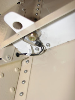

Finally after fiddling with the reed switches for days now, I found the problem! Seems it is all in that "cushioned clamp" we are to use. Notice in the first photo, the nature of the clamp is to put the switch down too far, a little tweaking of the clamp, and presto, it all works like it is supposed to! Hope this saves someone else the troubles I had. It is the nature of the switch to NOT work if it is trying to "see" the magnet thru the steel handle.

Then after tweaking, see how much higher the switch will be positioned.

I had to shave off the rubber on the right side of the metal band (as shown in your second picture above) and that moved the sensor a nice bit closer.
Yeah, that was going to be my next trick if this did not work. I also shaved 1/8 off the pin handles, that helps a lot too. Once I straightened the clamps, everything worked perfectly.
I tried all these tricks but it just came down to the clamps affecting the relay seeing the magnetic field (or not, in this case). Instead of trying to fiddle around any longer with those steel clamps, I made some from scrap aluminum. I put a piece of silicone tube over the relays to cushion it from the clamp and the relays worked exactly as if the clamp wasn't there.
Before it worked great with the switch in place held by my fingers but then refused to see the magnetic field once it was held by the cushioned clamp.
The aluminum clamp fixed this issue and even gave me some leeway to decide if I wanted it more or less sensitive. I had to tone them down a bit to not trigger before the pin was in place on both sides.

I just spent the last two hours doing step 4, the testing of the reed switches. I was concerned after reading all what was posted on this tricky step and, sure enough, once everything was in place according to instructions, nothing was working. Reading the many postings on this issue did not clarify a lot what the issue is as there is a mix of problems mentioned, including those related to the first kits that got a retrofit later. I got a good lead when I read that it was useful to position the reed switch without the clamp. This allowed me to find out that the switch was kept too far from the arm rest by the cushion clamp. I just removed the rubber on both sides of the clamp where it contacts the arm rest and I reshaped the clamp to fit flat against the arm rest and lo and behold, this did the trick for both sides!
I saws that some enlarged the hole and even pushed the switch housing through the hole: no need to do that in my case. I just removed the 1/8 inch of casing indicated in the instructions so that the top of the casing aligns with the center of the hole of the switch. For the rest I followed the instructions.
