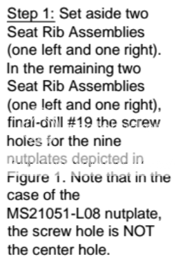

My son (Collin, 13) an I have been assigned section 21, and have been working on deburring parts for the past 3-4 weeks (we meet twice per week). We finally started assembly of section 21 today and have come across what I consider to be a pretty major question, which involves the instructions on page 21-05. I apologize profusely in advance if I'm making this more complicated than it is, but I would like clarification that I'm doing the right thing, so we don't have to drill out a bunch of rivets later.
STEP 1 states:
![](/proxy.php?image=http%3A%2F%2Fi101.photobucket.com%2Falbums%2Fm65%2Fjsburton%2FProjects%2FRV-12%2FVans%2520Forum%2FScreen%2520Shot%25202016-01-02%2520at%25206.45.26%2520PM_zpsq8cbgyfm.png&hash=24a49eeb669f0dd19d8b4017ef919332)
There are four (4) total ?pairs? of seat ribs; one left and one right in each pair. I interpret this instruction to mean the one pair that the Seat Belt Attach Lug Support were previously installed, because of "Figure 1", and one pair that has yet to be touched.

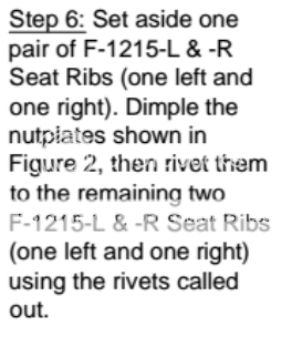

Then, STEP 6 states:
![](/proxy.php?image=http%3A%2F%2Fi101.photobucket.com%2Falbums%2Fm65%2Fjsburton%2FProjects%2FRV-12%2FVans%2520Forum%2FScreen%2520Shot%25202016-01-02%2520at%25207.01.52%2520PM_zpsvadxoewy.png&hash=06f65b100433306ff38d6360ddee3ece)
Meaning, one pair from step 5 does NOT get the nutplates installed in the four (4) locations act are on the forward angled portion of the seat ribs. STEP 6 instructs to only install the nutplates in the four (4) locations on the forward angled portion of one (1) of the two (2) pair of seat ribs.

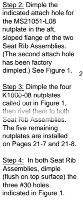

After STEP 6 I believe the following should be present:
*One left and one right seat rib with the seat belt attach lug supports riveted, #19 holes drilled nine (9) places, four (4) nutplates (K1000-08) riveted on the forward angled portion of the seat rib on each, three (3) #30 holes dimpled on each, and one #40 hole dimpled on each for the MS21051-L08 nutplates.
*One left and one right seat rib that are the same as above, but WITHOUT the seat belt attach lugs supports
*One left and one right seat rib with #19 hole drilled four (4) places, WITHOUT the nutplates installed four (4) places on the forward angled surface of the seat rib, and WITHOUT #30 holes dimpled three (3) places
*One left and one right seat rib with #19 hole drilled four (4) places, WITH the nutplates (K1000-08) installed four (4) places on the forward angled surface of the seat rib, and WITHOUT #30 holes dimpled three (3) places

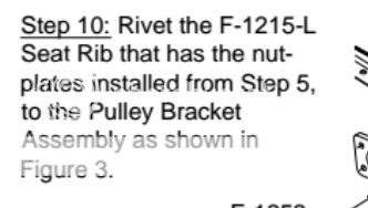

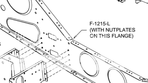

If all of that is true, then I believe that this note in Figure 3:
![](/proxy.php?image=http%3A%2F%2Fi101.photobucket.com%2Falbums%2Fm65%2Fjsburton%2FProjects%2FRV-12%2FVans%2520Forum%2FScreen%2520Shot%25202016-01-02%2520at%25207.32.59%2520PM_zpspsfshue8.png&hash=a4d6ba64da6bda92af57e450a6926703)
...for STEP 10...
![](/proxy.php?image=http%3A%2F%2Fi101.photobucket.com%2Falbums%2Fm65%2Fjsburton%2FProjects%2FRV-12%2FVans%2520Forum%2FScreen%2520Shot%25202016-01-02%2520at%25207.02.55%2520PM_zpslifa0z9x.png&hash=331452f7957023d6e97e9c377c679315)
...is calling for the pair of ribs with #19 hole drilled four (4) places, WITHOUT the nutplates installed four (4) places on the forward angled surface of the seat rib, and WITHOUT #30 holes dimpled three (3) places. Yes...no?
