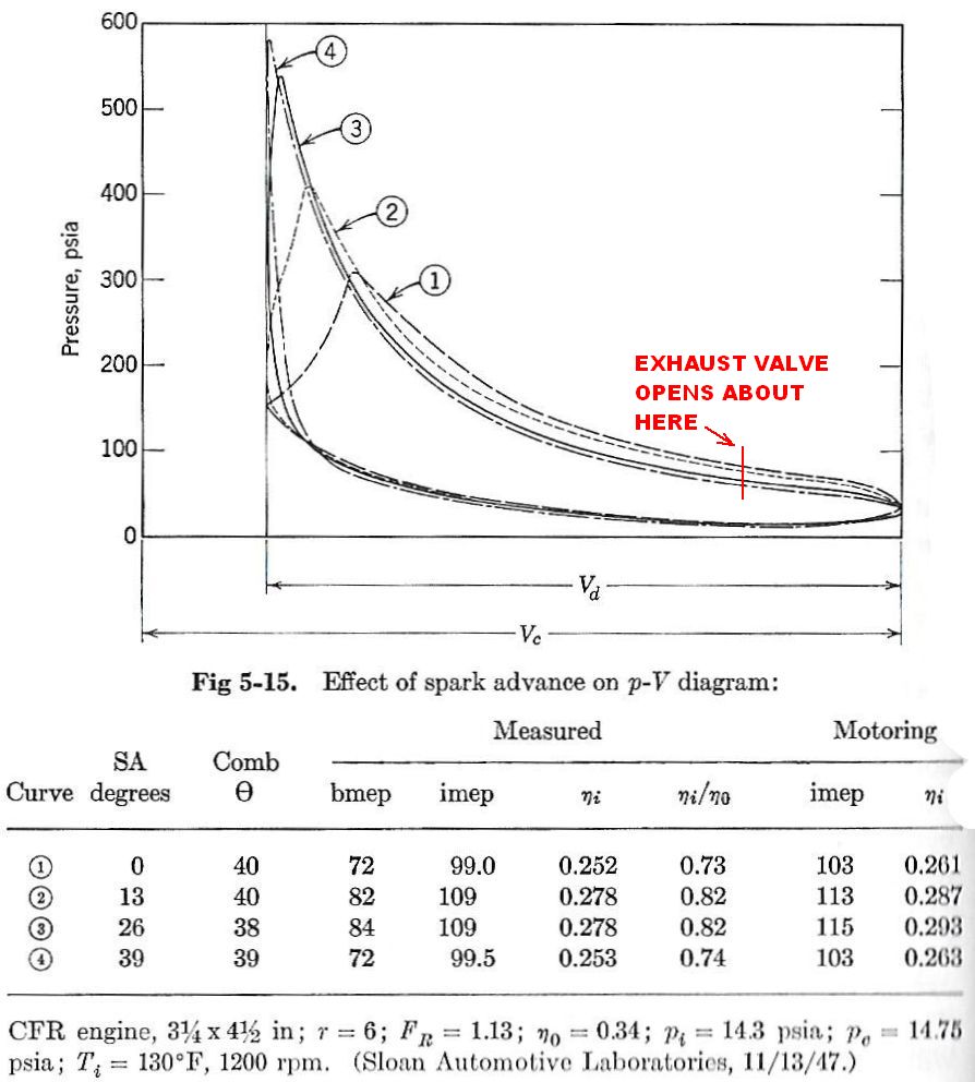

I am writing the following to help explain how the timing should be set on engines running P-mags.
This seem to be especially important for those running angle valve engines (IO-360, 390, & 400's).
The following assumes the P-mag timing marks are set at the TDC. All examples for standard 8.5:1 compression parallel valve engines. Below will be some numbers for angle valve engines.

A few comments about P-mag configurations:
1. We have not heard of any Lycomings where the P-mags should be run on the "B curve" (no jumper). The "B Curve" starts firing the ignitions at 30.8 degrees BTC and advances out to 39.2 degrees.
2. The configuration Axel has selected appears to work very well for Parallel valve engines. We have enough experience with it to say that in a typical installation, this will reduce the CHT's 10 to 20 degrees F and increase speed a few knots over the standard "A" - jumper in configuration.
3. If you run an angle valve engine (IO-360, 390, 400, etc.) that requires a 20 degree timing, neither the "A" nor "B" curve should be used when the P-mag's timing mark is set to TDC. Using either of these configurations could damage your engine.

These engines should never be set at TDC and then run with either the jumper in or jumper out. Either of these configurations may damage your engine when the TDC mark is set to Top Dead Center.
CHT cooling on angle valve engines seems to be much better than parallel valve engines. Do not take acceptable CHT's as an indication that all is OK with your engine while running excessive advance in your angle valve engine.
If you have a high compression engine, consult your engine builder for the proper timing advance.
