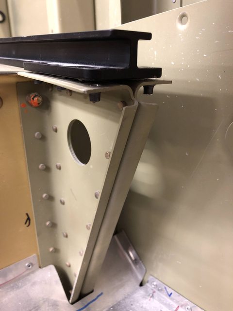

Outboard mid seat rail support
One suggestion-- before tightening down the bolts, check that the seat rail holes line up correctly with the support in place.
I had both supports in place for awhile and then found out that despite being CAD designed, they did NOT line up with the seat rails :eek:. If you think putting them in is a PITA, try taking them out to fix them and reinstalling them TWICE :mad:. And yes, I had installed them correctly. My initial installation was checked and verified by a repeat Rv-10 builder and local DAR.
My solution was to slot the support mounting holes and trim off the entire back flange for clearance off the main spar bolts.

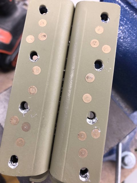

Resurrecting old thread as a result of a search for answers-
You, sir, sadly, win my internet today for truth in advertising.
Trimming off the back edge of the mid bracket was to be the next step - and may be what I should have done, since slotting doesn't help much if the part can't slide more than 1/16" in the needed direction.
Instead I enlarged holes in everything over top of the nut plates (bent one of those plates over, too:mad:) and somehow got most of the screws to go in catawumpus but with threads engaged nonetheless.
Moving the mid seat rail bracket aft serves to wedge the seat rail upward necessitating 0.10" shims at the aft bracket to keep things straight. I'm still working on that.
Thankfully these shenanigans were only needed on the passenger side outside rail; everything else was close enough to correct with a #14 chase-drilling of multiple screw holes for clearance.
I will say this as calmly and objectively as I can: if the remainder of the 10 kit represents today's industry standard for aircraft kit workmanship, this one portion of the 10 kit is utterly beneath Van's reputation for quality. This is not an isolated issue, and there is nothing in the plans to assist the builder in installing this out-of-spec part and the cascade of issues its installation causes. A plans revision, at the very least, is in order. This is an area where oversize holes and floating nut plates would save a lot of grief.
Old thread, but I'll add to the chorus of complaints.
The pilots side bracket is too far forward by 1/16" on my airplane. I spent two hours in the garage pouring sweat last night to attach both brackets. Now,I've gotta remove one of them, slot holes, and reinstall.
There's gotta be a better way on this...
OK, I just finished reworking my pilot side bracket. Things fit now. It only took a couple of hours to find and fix the issue in the 800F inferno that is my garage in July.
Here's a helpful hint for getting the bolts in:
Start with the outboard aft bolt. Don't even insert the others. That gives you the ability to twist the bracket, wiggle the bracket, etc to get a better look at what you're doing on the hardest to get to bolt so you can get the nut threaded.
Once you get that nut threaded, the other 3 are easy in comparison.
