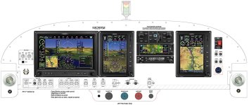

I'm getting ready to start laying out and assembling my panel. I've decided on the avionics and have purchased them from Stein, but now I'm having thoughts of adding a second display. Here is what I have so far:
10" G3X - PFD
G5 backup with integrated battery backup
GTN 650 Xi - Navigator, COM1, NAV radio
GTX-45R - remote transponder, ADSB in/out
GTR-20 - remote COM2
GMC 507 - autopilot
GMA 245 audio panel
I had originally thought I'd mount my ipad on the passenger side of the panel, but now I'm thinking that maybe I'd like another G3X over there (10" or 7") so that I could declutter the PFD by displaying engine instruments, nav map, and so on on the 2nd unit.
The thing is, I don't have any experience with the G3X or glass panel displays. All my flying has been with steam gauges augmented by G5s and a Garmin navigator, so I don't have a good feeling of how useful a second display would be, thus, I'm looking for guidance.
Thoughts?

Wow, thanks for all the replies. Good ideas here and gives me a lot to think about. I had not considered mounting the two MFDs side by side as some of you have done or suggested. That is something to consider. On the one hand it'd make it easy to use both displays, but it'd make it more difficult to use the navigator, audio panel, and the AP.
My initial layout was to have the 10" MFD on the left in front of the pilot. The center stack would have the G5 at the top, next would be the audio panel, then navigator, and at the bottom would be the AP. My thinking was that I wanted the AP on the bottom near prop and mixture controls, so it'd be easy for my hand to reach up and make a change. This seems logical to me, but I'm laying something like this out for the first time so comments welcome.
I think I would like to put a second MFD in the panel. Since I have the G5 I think I'll use the same ADHRs as the first MFD. The question is will it be a 10" or 7"? There is about a $900 difference between the two, but I think given the overall cost, $4250 vs $3333, possibly the 10" unit might be the way to go.
