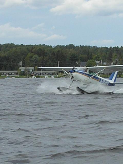

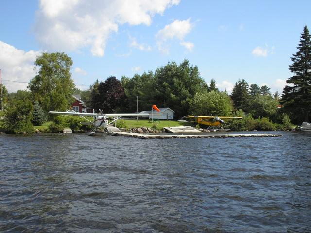

What lake are you on? I just got back from Rangeley, Maine (M57) and did some recurrent training in the 172 and 180 they have there.
