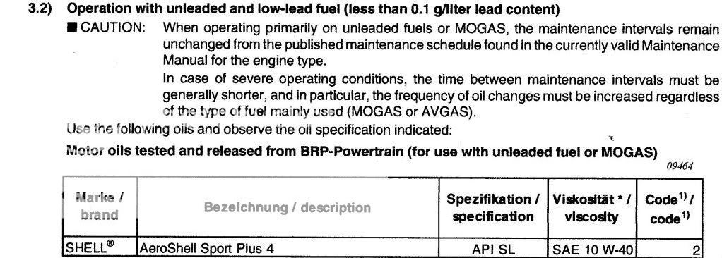

First thing I Noticed was again the only oil Rotax actually tested was:

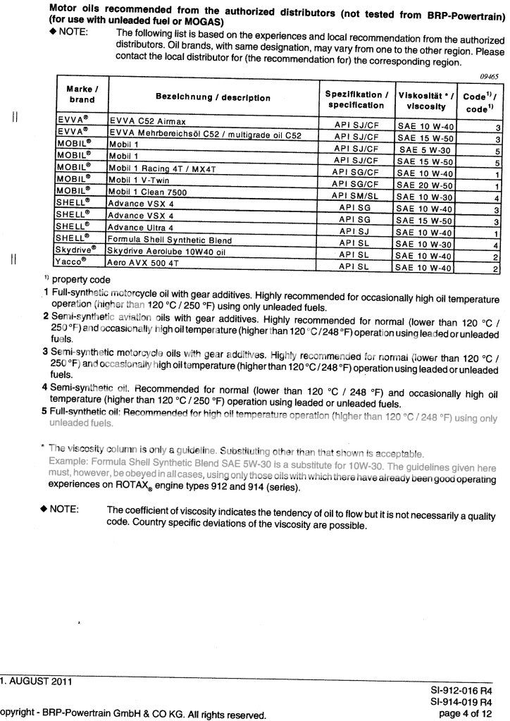

The next Oil they recommend was oil based on recommendation from , "Authorized Distributors" what ever that means. Also see the notes about what the codes mean on the far right of the list:

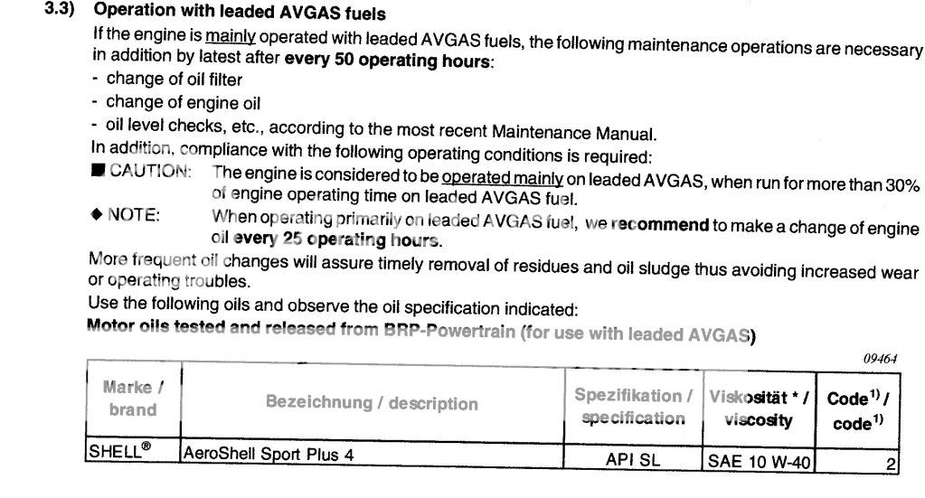

Now here is an interesting tidbit about adjusting when to change your oil if you are running Avgas (100LL) and again the only oil actually tested by Rotax was Aeroshell Sport 4. the rest were fom recommentdations from authorized distributors and are not shown in this pic:

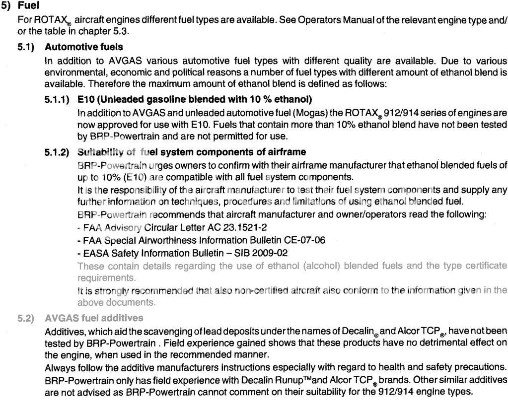

The next thing of interest is this info about what type of Auto fuel you can use. Make a big note of 5.2 Avgas fuel additives cause there are a lot of rumors floating around about TCP and Decalin and also note that these are from field Experience:

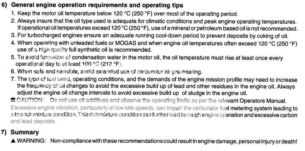

Then last but not least is the General engine operation requirements and operating tips. Note number 1. which has been discussed at length here on the form during the hot summer months and Note 5 is interesting cause somewhere someone came up with 190F for water evaporation. Maybe a hold over from Lycs and Conts.;)

Regarding the use of additives, is everyone using them when Avgas is used? Mitch Locke runs his 12 exclusively on avgas and uses an additive (one of the two mentioned-not sure which one). Mine has had a steady diet of mogas so far, but that will change with availability on trips. Which product are you guys using and where do you get it?
Decalin
I have a bottle of Decalin I bought from A/C Spruce. I carry it whenever there's a possibility I might have to use 100LL. So far I haven't gotten far enough from home to need it. Decalin can be carried in the cockpit much more safely.

Page 16 of Section 05-20-00 of the current Rotax Line Maintenance Manual says the oil should be changed at 100 hours, or 50 hours if running on 100LL.
However, SI-912-016-R4 Section 3.3 first lists 50 hours, then farther down this changes to 25 hours.
So, what is Rotax really saying here? 50, or 25?
Secondly, has Rotax published an opinion on the use of additives, such as Decalin?
Use the latest info!
John, Use the SI-912-016-R4 info, its the most current. Its easier to update info with Service Instruction letter then go back later and change the manual. Probably somewhere down the road when Rotax gets a chance they will update the Manual. ;)
Via everything I have read. If using 100LL, a 25 hour oil change is recommended. If not, a 50 hour oil change is conservative.

Quote from page 12 of SI-912-016-R4 reads:
"To avoid formation of condensation water in the motor oil, the oil temperature must rise at least once each operational day to at least 100?C (212?F)."
