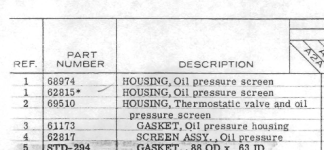

The Lycoming Parts manual (PC-103) for my O-320 call the oil filter screen item 4 part number 62817 "SCREEN ASSY., Oil pressure".
Screenshot 2024-04-19 at 9.17.02 PM.png Screenshot 2024-04-19 at 9.17.24 PM.png
I would call the oil pickup tube screen the one that we inspect at least at the condition inspection. Lycoming parts catalog call it "SCREEN, Oil suction".
Screenshot 2024-04-19 at 9.19.21 PM.png Screenshot 2024-04-19 at 9.19.44 PM.png
When I acquired the engine for use in my RV-6, it had the screen to filter the oil and I changed it to a spin on filter like most newer engines came with.
View attachment 61055 View attachment 61056
I was wrong, I thought item 17 is what you are referring to. I have not seen an engine with the type that you have. This goes to show that I am still very much a rookie :)

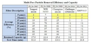

BTW, here's an illustration which may help with understanding. The ISO 4548-12 filter efficiency test records particle counts and sizes in the green shaded range. The ICP spectrometer would detect the elemental components of particle sizes in the red box or smaller, but can't detect the larger particles. The solubles test should detect all solids, but bear in mind the very small sample size,
That one shows insolubles dropping back to 0.2%, but it was only 19 hours. Still not conclusive one way or the other.
BTW, here's an illustration which may help with understanding. The ISO 4548-12 filter efficiency test records particle counts and sizes in the green shaded range. The ICP spectrometer would detect the elemental components of particle sizes in the red box or smaller, but apparently can't detect the larger particles (to be confirmed). The solubles test should detect all solids, but bear in mind the very small sample size,

As noted in a prior link, the industry considers 10 µm as a practical detection limit. All the filters are roughly similar at 10 µm and less, so yes, the spectrographic silicon counts should be similar. The screens rapidly become useless above 10 µm, but you can't see it in a spectrograph report.
We also talked about insolubles. The reported value is the percentage of the sample by volume. We're talking, ballpark, one half of one percent of a very small sample, and it's all the garbage lumped together. Although they do not routinely identify the makeup of the insolubles, past experience says it's mostly lead. Put another way, a change in silicon content would be a variation of a small percentage of a small percentage.
Bottom line, a spectrographic oil analysis tells almost nothing about filter performance.

Someone once said, jokingly, that anything caught by the suction screen would be large enough to have a part number on it. The perforation hole size in that screen is about .050" which is over 1200 microns. That's comparatively the size of a boulder.
Mehrdad, the "big chunky bits" are those particles 10 µm and larger.
The spectrograph is blind to particles above 15 µm, and doesn't always detect solids in the 10 to 15 range. Larger particles are not reflected on your oil analysis.
The Challenger and S-15 screens catch a few particles below 10 µm...roughly 3x less than a Champion or a Tempest, but a few.
From 10 µm to around 100 µm, the Challenger and S-15 don't really catch anything. Above 110 µm or so they do catch, but the larger particles clog them very quickly.
....wouldn't one expect those big chunky items be caught by the filter and would mostly apply to those planes that lack a filter and rely only on a screen?
Operators with a depth media filter can expect the efficiency values posted previously. Those with screens are not filtering much of anything under 100 µm.
... wouldn't one expect those big chunky items be caught by the filter and would mostly apply to those planes that lack a filter and rely only on a screen?
As Dan just explained above, we're talking about relative sizes here. The "really big chunky bits" that your filter removes are huge compared to the particles which still get past your oil filter media, but even those tiny particles are still very big compared to what the SOA machine is looking for.
When you have an engine suddenly "make metal" the SOA process is often unlikley to return anything abnormal, because if you can see it with the naked eye then its far to big to be placed into the spectrographic analyser. I've had many customers come to me with a fairly normal SOA result yet the filter is full of metal particles.
Thank you Dan for explaining this in a way that I can understand. Would it be correct to explain this as following; we don't see much different results in the oil analysis with different filters because those larger particles are prefiltered by the SOA process and this is why we don't see them in our report. If those were not prefiltered, then we should expect to see much more with the S-15 type than Champion.
I think there is some confusion in the above.
The preparation of a submitted oil sample includes multiple steps, one of which may or may not be filtration to protect the test equipment. Typical ICP spectroscopy is blind to solid particle sizes above 10 µm, so removing those particles prior to test makes no difference in the final result. Filtered or unfiltered, same result.
Put another way, you don't see the elements contained in the large particles because it's a limitation of ICP spectroscopy, not because of any sample filtration.
