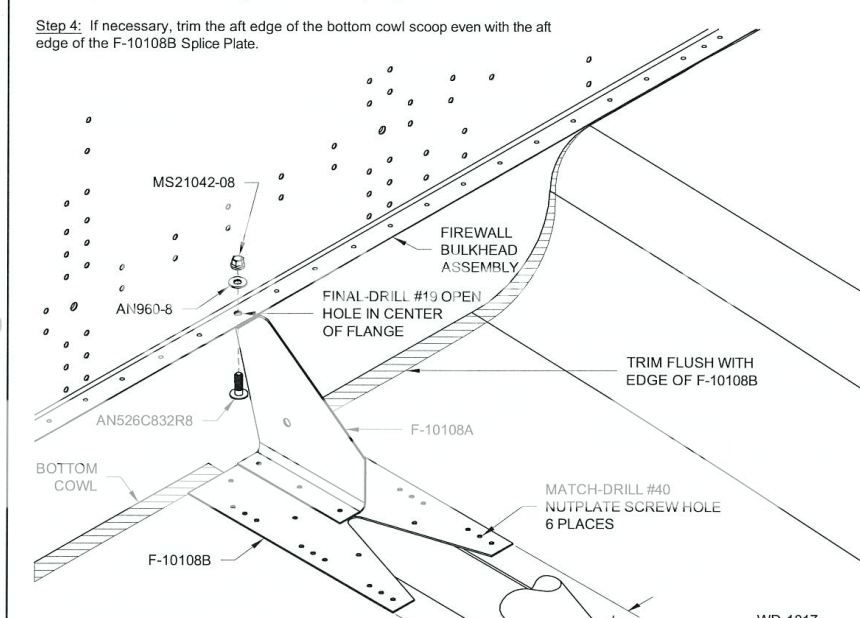

CharlieWaffles
I am looking at the lower cowl steps (47-11) and it shows to drill the firewall tab for a #19 hole and use a AN526 screw and nut to hold the splice plate for the rear portion of the lower cowl. Any reason to use a nutplate here? It seems it would be easier to install and remove the cowl without having to reach in and hold a nut to do so.
