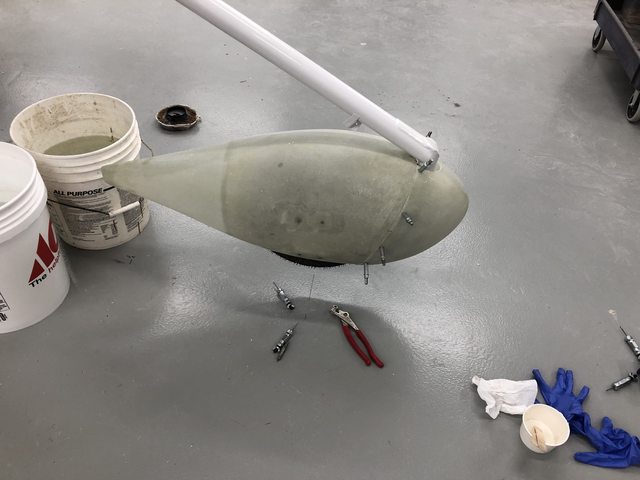

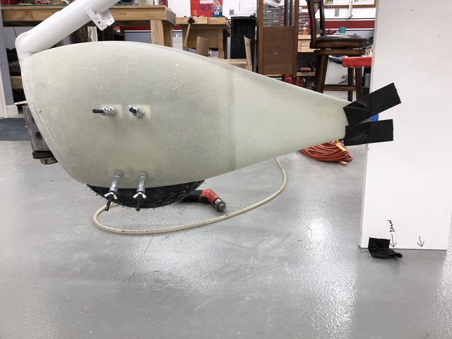

Looking at the design, it seems like the brackets on the rear half of the pant are meant to slide on and off the fork to remove it. If that's the case, it seems safe to treat the attachment of the brackets to the pant as permanent - meaning one need not worry about the flox engulfing the bracket ears (vs the main pants, where this was a specified concern.)
Is that correct? If so it will give me much-needed liberty to reach in there and slop it on - since I see no way to apply it to the pieces first and then assemble them without scraping and smearing flox everywhere but where I want it.
