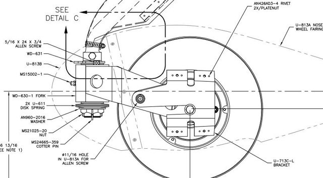

A couple of the brackets that secure the nose wheel pant are broken on my -7A and Im trying to figure out the correct part numbers to order. Vans is closed today, but searching here I found a reference to V-1013C-L and -R. However, I need both front back brackets and I dont think they are identical, so I have missed something. Can anyone help me out?

I believe you need U-713C-L and R for the -7A nose wheel pant.
Hmmm. Thats not what mine looks like. I have two separate brackets, one up where the allen screw goes, and one back at the axle. Guessing things have changed since my build.

It sounds like you have the original style (non pressure recovery) wheel fairings. They have been obsolete for many years, but I think are still available as replacement parts (but I don't know the part #).
Did you build the airplane?
If not, this is an example of why getting plans when purchasing a completed airplane is so important.
Old style
I believe your looking for;
U-813D Left & Right
U-813C Left & Right
If you have the old style pants, the part shown in the picture above will definitely not fit. The good news is that it's pretty easy to bend some scrap aluminum and make the dual brackets you need for your setup for virtually $free.
Was able to find a set of plans and found this:
Rich has it right above; U-813 C & D.
Will see if Vans still carries these or Im on my own for fabrication.
Whats interesting is that the nose wheel fairing part number is the same as shown in the previous post (U-813A) , so doesnt seem like that has changed?

A quick check on Vans website indicates they carry U-813D but not U-813C.
Seems strange they would have one but not the other. Also, the description for U-813D says "PR nose fairing brkht". Assuming "PR" means pressure recovery, this again suggests I do have pressure recovery wheel fairings and the brackets have changed rather than the fairing itself.

Yes, you do have the pressure recovery pant with the older style brackets.
Mine was like that. Before I painted my plane I changed to the new style. I like them better. Easier to remove and reinstall. Take the Allen screws out and slide the wheel pant right off. The new ones slide over the axle bolt washers. I attached the brackets to my wheel pant and they are now part of the wheel pant.

You may indeed have them.
There was a transitional period that the new nose wheel fairing used the old style brackets. But with the very limited information that you provided, I took my best shot at giving you what you were looking for.
That is why referring to plans that were used to build the airplane is always the best way to research parts needs.
