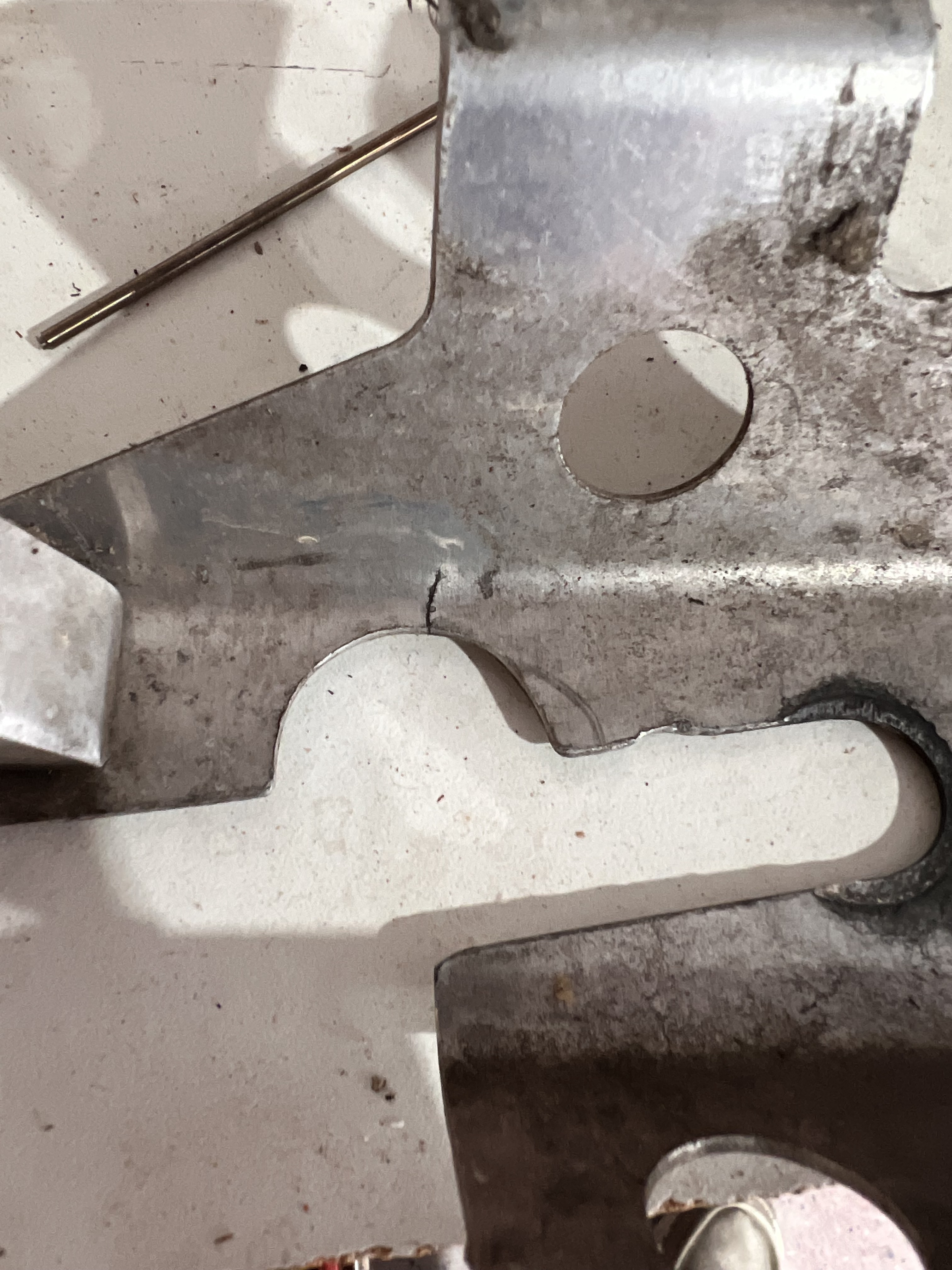

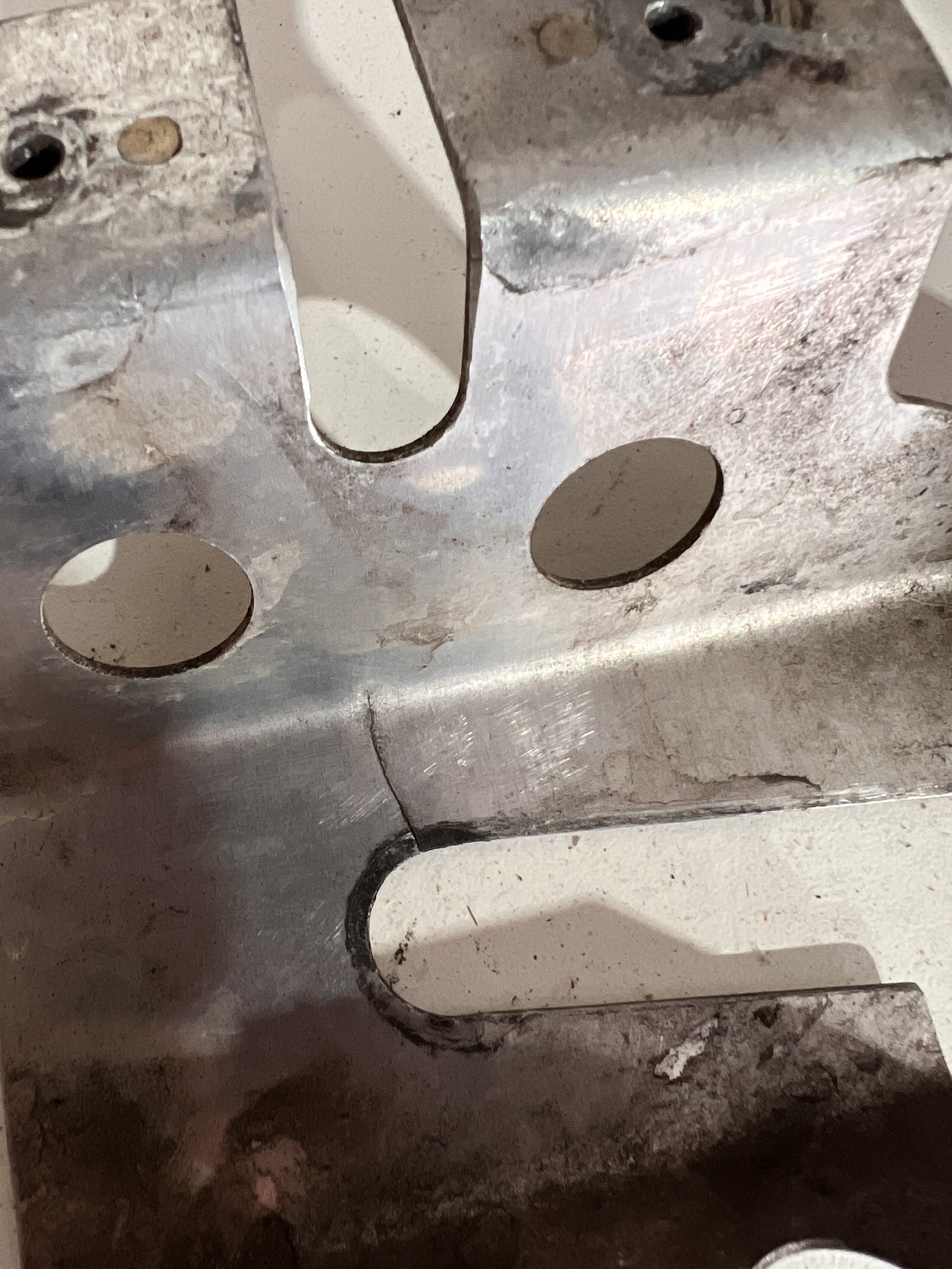

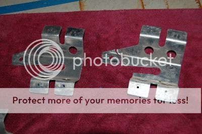

I bought my -10 about 2 years ago. Last spring I had the left side nose wheel fairing bracket break and the left was cracked. Luckily no damage to the wheel fairing. I replaced both and made sure the brackets were smoothed out to relieve any potential stress points.
After returning from New Orleans Saturday, I saw the bracket had broken again after 100 hrs from the last time.
The bracket on the right broke last year, the one on the left broke this weekend. Note how the break is virtually identical. The right bracket also had a crack.
Obviously if I use the factory bracket, it will break again. Has anyone come up with a beefed up bracket to fix this issue? I searched and only found improved brackets for the main gear.
