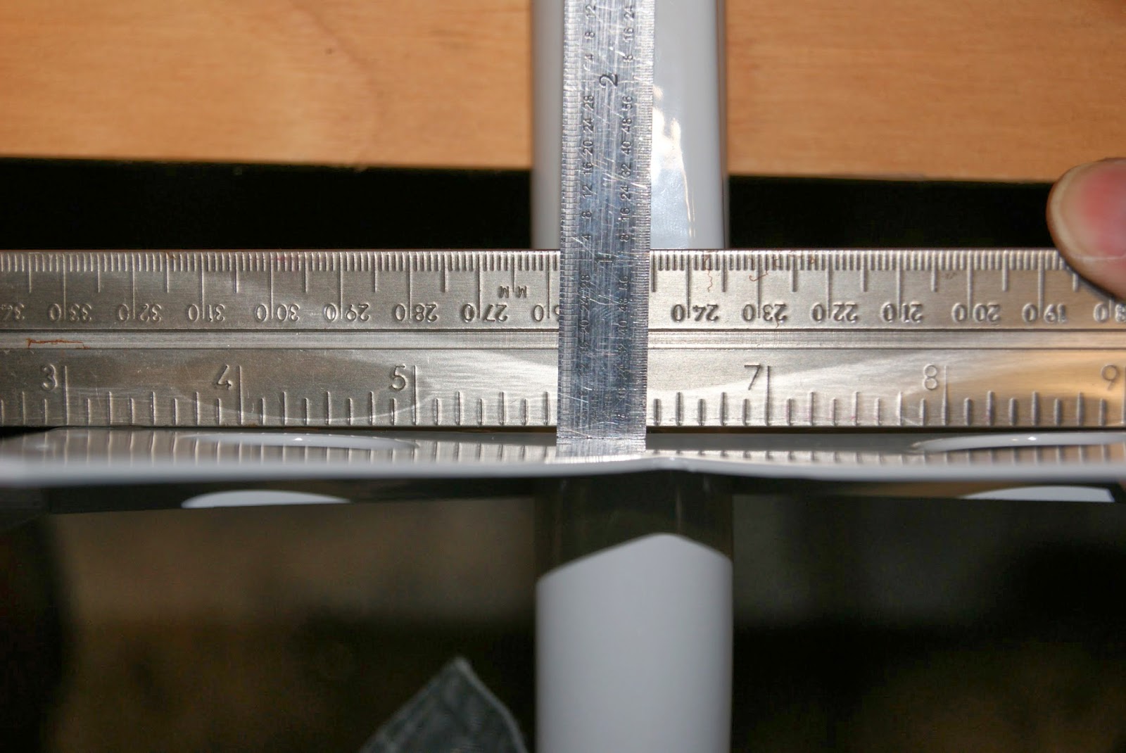

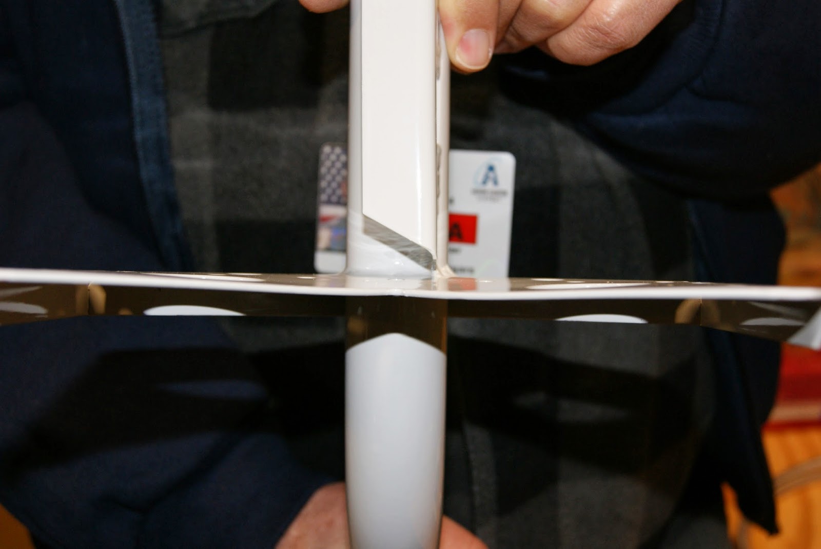

Made a trip to the hangar yesterday with the camera to take some photos to send off to Van's. Here is what my WD-1201 gear mounting plate looks like.
This first photo is looking at the mounting plate almost straight on.

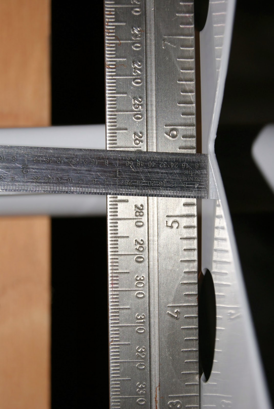

The second photo is using a straight edge and ruler ... the gap as measured at the center of the aft portion of the mounting is a hair over 1/8".
Because of a weldment in the way, the gap is not easy to measure where the mounting holes are. However with the straight edge as far forward as the weldment allows, the gap measured just under 1/8".
Will send off these photos this weekend to Van?s support to see what they have to say about the issue. The warpage looks excessive to me ? so guessing they will replace the unit but will have to wait until next week to find out the verdict.
Curious if the above photos look like yours Mitch?
All is well

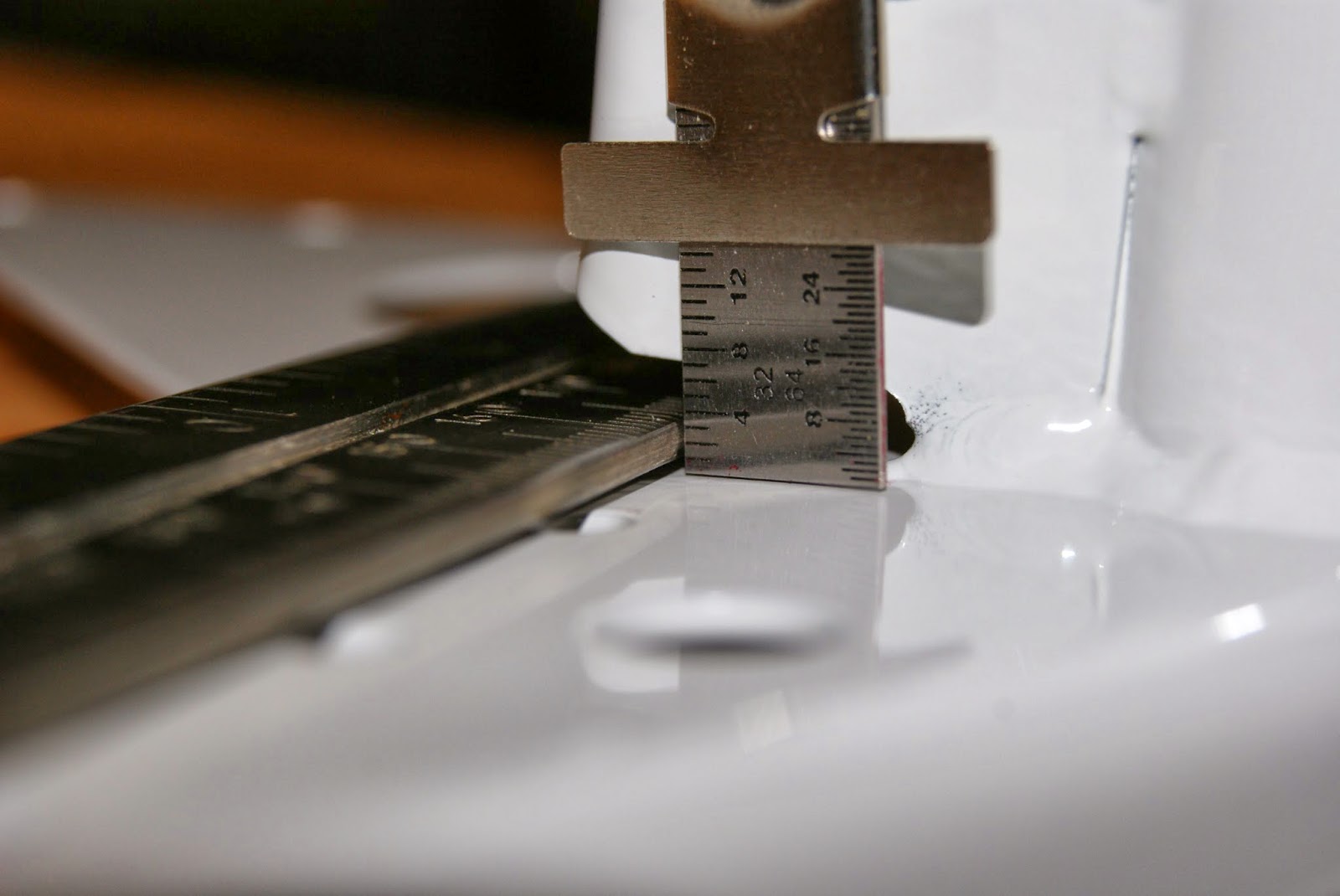

Monday I received a call from Sterling at Van?s wanting to know how much warping was there at the forward mounting holes. Sterling said the maximum allowable limit was approximately 1/16" but all my photos were taken aft of the mounting holes so he wanted me to make a measurement at the mounting holes.
So today went up to the hangar and laid the straight edge across the mounting holes of the WD-1201 front landing gear?s fuselage mounting plate and took another measurement which yielded approximately 1/32" of warping at the forward mounting holes ? which is well within the acceptable 1/16" limits Sterling at Van?s stated.
Sterling explained to me that after the welds are made, the whole assembly is run through a heat treating process which often induces some warpage in addition to the warpage created by the welding process. However, this additional warpage is mostly generalized in the area aft of the mounting holes between the two lightening holes (as seen on mine) ? apparently the two lightening holes in this area of the plate also contribute to the warpage. The main thing ? all is well with my WD-1201 assembly as it is which is good news for both me and Van's.
