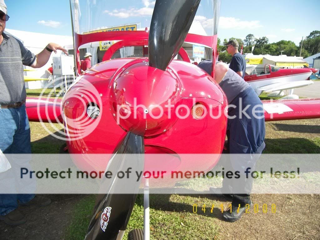

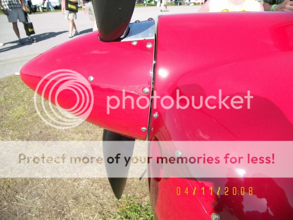

I was looking at the cover of the Nov Sport Aviation magazine and saw the VAF hat as well as something weird on the spinner of the RV-12. Sure enough when I looked at page 29 of the magazine I saw what looks to be a piece of fuel line sticking out on the spinner. Does anyone know what it is and it?s function?
Pitot Tube
I'm pretty sure that tube sticking out of the spinner is the pitot tube. Pretty fancy huh?

I was looking at the cover of the Nov Sport Aviation magazine and saw the VAF hat as well as something weird on the spinner of the RV-12. Sure enough when I looked at page 29 of the magazine I saw what looks to be a piece of fuel line sticking out on the spinner. Does anyone know what it is and it’s function?
Bob's right. Here are two of pictures that Jerry took at Sun 'n Fun:
If you look close, you can see in the second picture it has a "technical bevel" to allow it to handle high AOA situations. The reason it is there is to simplify the wing removal process. Thanks for the good pictures, Jerry!
--Bill
How does that work???? Is the pitot tube stationary? And could it be done on other airplanes or is due to the way the rotax engine is implemented? :confused:
Yes, it's stationary.
It can be done on any airplane with a hollow prop shaft (like the gear reduction Rotax)
There would be no benefit to having it on other airplanes. It is only on the RV-12 because of the quick removal wings...no pitot connection issues or pitot tube that could get damaged
