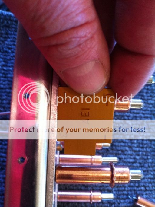

I do recall something in that section where a few of the rivets were too short. Both short with a rivet gauge and when squeezed, was undersized. Stepping up to the next length worked fine.
Can't find the correct picture with the -4 gauge in the shot, but here you can see the stock rivet was too short even for a -3.
rivet length
