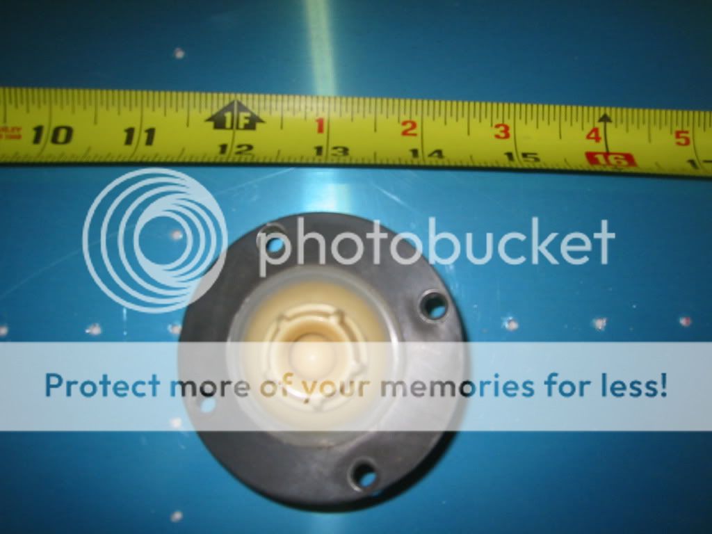

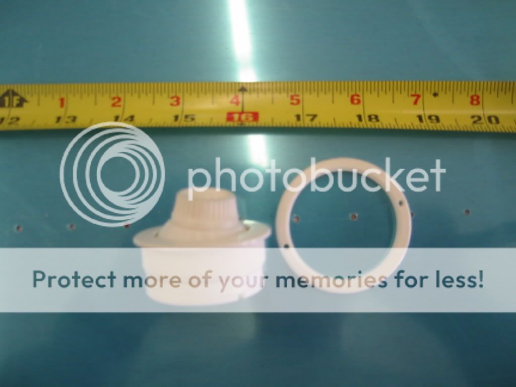

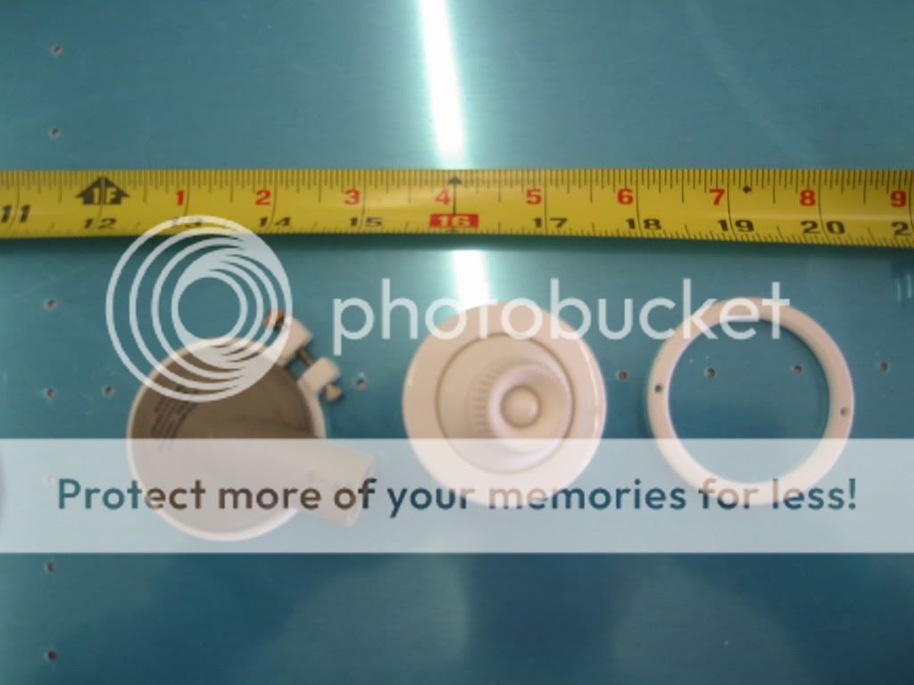

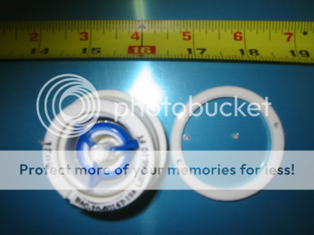

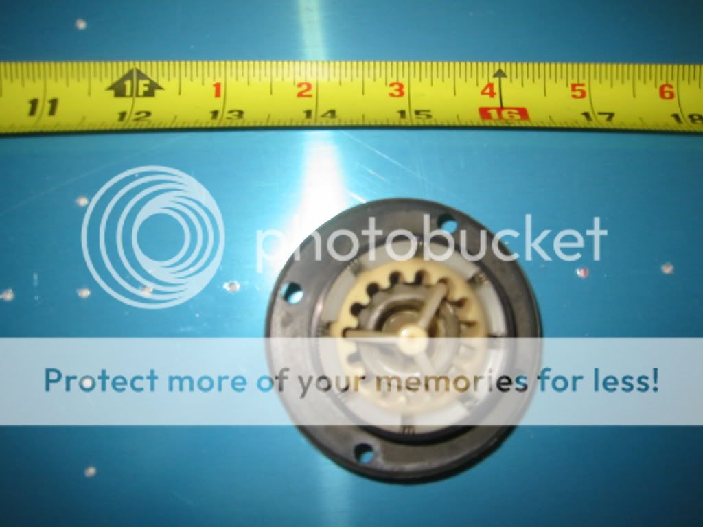

A neighbor has a large number of surplus (new) overhead vents from Boeing 727s. They could be available at lower cost than what is out there now.
There are two styles of vents. Both would work well with the Aerosport console. One mounts with 4 screws, the other has a ring that clamps it in place. They are very tight when closed.
They were designed for a pressurized system, and I am wondering if the will have enough flow our application. The hose connection (which would not be used) is for a 5/8" flex hose. I suspect the air header in the 727 was pressurized to provide sufficient flow.
Does anyone know what pressure they used in the original application and if there is enough pressure in our use? I notice that most of the vents for sale are 1.5" or so. These are about 3/4" or so.
Photos included.

I have exactly the same in my rv-10. It was built by a a&p and he probably had access to these vent.
I found that they are too small. The opening of the vent is too small and there is not a lot of air that come out. The connector (gray) is too small too. In my comsole, tube has been pass to the connector. Others just pressurize the console and put the vent without tube. Probably better. I change the vent dor bigger but think that the 90degre connector put too much restriction.
The real thing is, if you put the big vent 1-3/4 for pilot and copilot and you put the vent on the side for passengers, you don't really need the vent on the console. I have them but barely use them.
Finnaly, i would be interest to buy a couple of these vent because i need spare part. I didn't knew wherer they were comming from and i need the 90 degre gray part and the plastic ring. I removed the vent but still use the 90degre connecor
