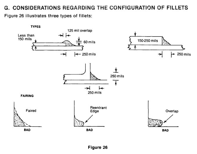

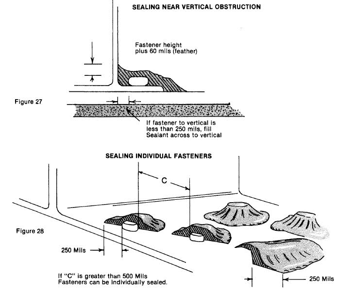

This first picture shows the general approach and sizing for sealant. The second photo shows how to overcoat seams and potential leak points. Basically, it adds the suspenders to the belt for more sealing security.
