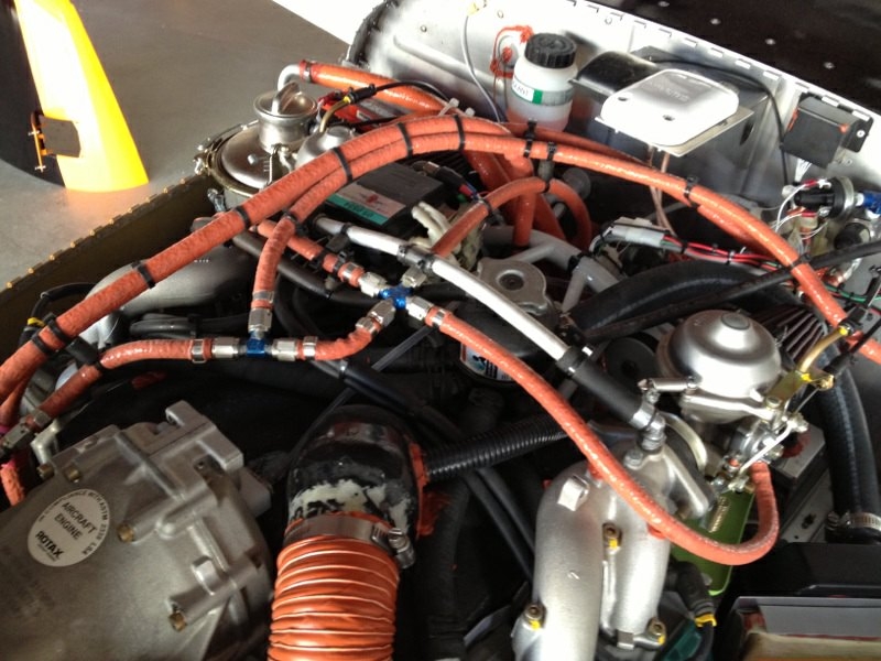

For those of you that might be wondering---yes you can use stainless braid teflon with crimped hose ends for your Rotax applications. I have several out there right now. For those using an ethanol fuel and a rubber hose, yep the 5 year replacement or sooner is advised. (If I can figure out how to post the pics, I will.)
Tom
Tom asked me to post this picture.
As he mentioned, we are able to build Stainless Braid Conductive teflon hoses and adapt them to a rotax/jabiru, etc. engine. We can effectively eliminate the 5 year replacement issue by using a hose that has no time rated life. In addition, we are able to provide a much more compact package that is lighter than the standard rubber hoses at an incredible price point.
There are some additional pictures and more information at:
http://www.aircraftspecialty.com/kitplanehoses/hoses.html
click on the "Rotax" tab.
Or, please email Tom at [email protected].

Yes....
We are currently just starting an RV-12 build. We will be offering a complete retro kit.
But, for those who want them now, we can build the hoses to custom measurements.

Right now I probably will not be at OSH. But--if you'll email me, I'll tell you anything you want! The pic that Steve posted here is of a RV12, with a slightly modified fuel pump to accomadate the AN hose ends. The original Rotax hoses are rubber, with either low pressure crimp bands. Some applications of the same engine are using hose clamps. Mine are my standard stainless teflon hose, with stainless hose ends. An AN tee, and an AN cross are used in these assemblies.
I basically copied the original hoses, so everything fits.
My email is [email protected]
Tom
OH yeah---that hose package is on John Jones' beautiful RV12 in Fort Worth. John was nice enough to email me the installed pics. I'm pretty sure if some of you are in the Ft Worth area, he would not mind at all if you looked at his installation.

Bob and all--
I feel the 5 year replacement on the Rotax hoses is like the old AC20-7N, which stated hose pressure tests every 100 hours, and replacement at 5 years. Now, I dont know about you guys, and some of our A&P and I&A guys can tell us (me)---who was REALLY pulling hoses at 100 hours and pressure testing them? I've done some 303 hose for some people that had 15-20 year old date codes. ( I saved one that I did in 2006 that had a date code of 1966, and was still flying).
But what I can tell you from my automotive experience is that ethanol will eventually attack the neoprene/nitril liner of a rubber hose, like those on your Rotax, and begin to form some work harden cracks. Under flexing, these cracks begin to open up, and the hose begins to seep. Granted---your plane doesnt put anywhere near the amount of hours on it that your car or truck does. Late model vehicles have a teflon, or thermoplastic hose/liner combination, that isnt affected by the ethanol additives.
Rotax, and others are being safe by recommending the hose change. Just like the old 20-7N. Rubber hose is easy to install, way less expensive than teflon hose and crimped fittings. In some cases, it may be better and less expensive to just replace the hoses every 5 years. ( I dont know what the cost is of the Rotax hose replacements). But---IMHO--teflon will out service any rubber hose out there. Yes--it is overkill on a very low pressure system, but it is the best for this application.
Tom
Tom,
What would you consider the safe useful life delta between plain rubber hose and Teflon lined hose? Twice the service life (10 years)?
Tough question, since teflon has virtually an unlimited service life. As long as it isnt abused, abrased, or subjected to alot of heat, it generally will outlast the airframe. Rubber hose, neoprene, nitril, or those rubber based liner really should be changed out on a regular interval. Lets face it---5 years of flight time is pretty good.
One point that I will make is that teflon hose, although is pretty forgiving to abuse, it doenst like to be straighten out after being in its 'installed configuration'. Its like 303 hose in that respect. Ever seen a piece of 303 that has been on a plane for a long time---such as an oil hose? Try to straighten it out and listen. Sounds like a bowl of Rice Krispies. Teflon doesnt snap and krackle like that, but remember the liner is thin, so if you try to straighten it out, you can fracture the liner. So---if you do take one off and plan to reuse it, take care to leave it as it is.
I'd have to say that teflon should outlast a rubber hose by 5 times---so maybe 25 years? Ive seen some teflon assemblies on military aircraft with mid 60's date codes that were still flying. Great testimate to teflon---
