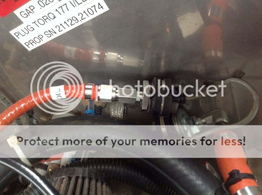

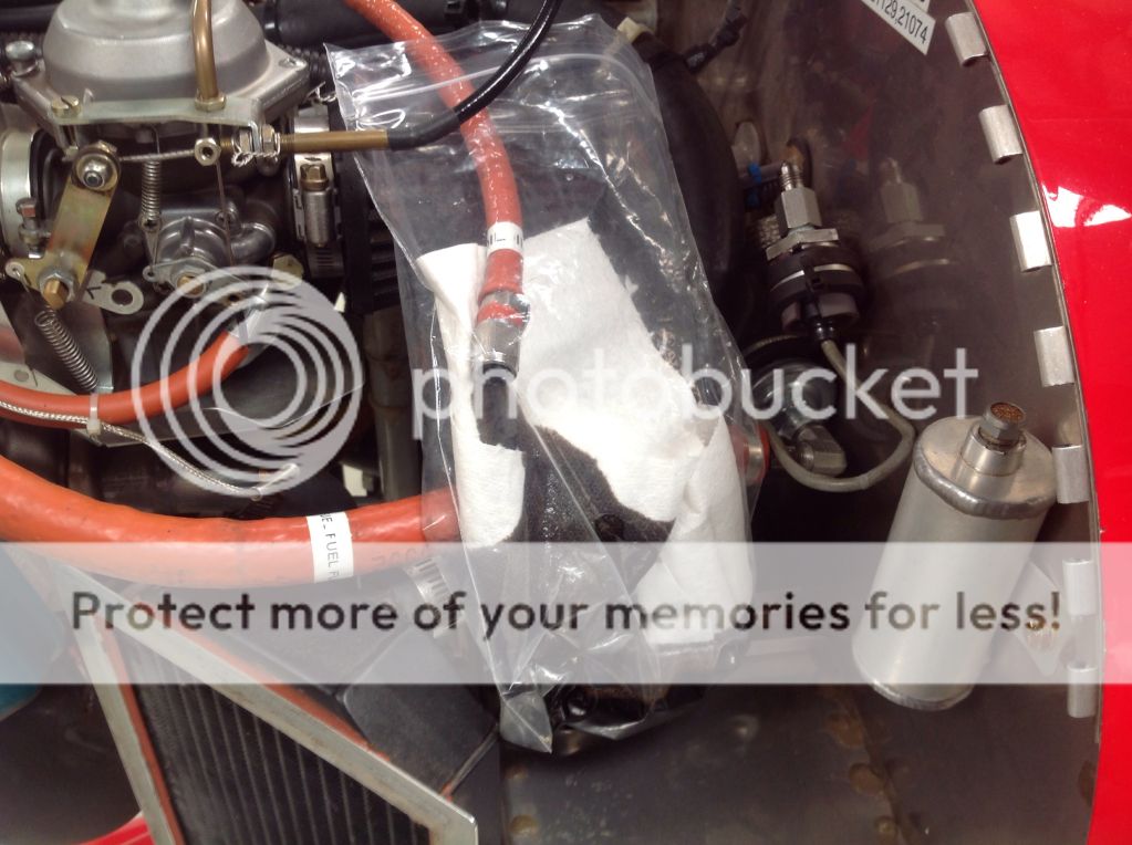

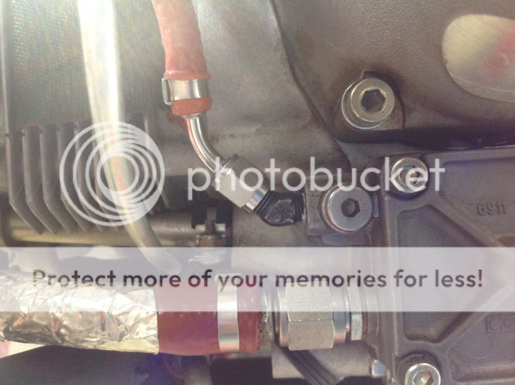

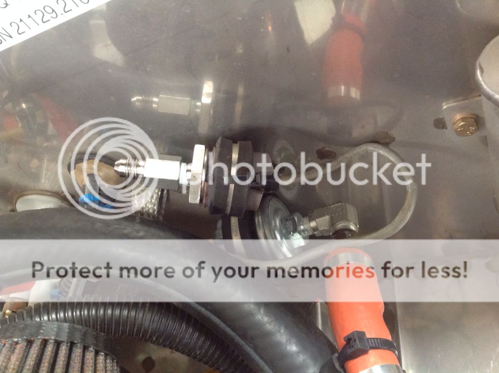

A few more thing about my remote oil pressure sensor setup!
I was one of the beta testers for this new product. Here are a few more shots of my installation. My serial number is 120079 so I have the pre Kevlico fuel pressure sensor. So I used the save bolt that holds the adel clamp for the fuel pressure sensor and came off 180 degrees with another adel clamp to hold the Honeywell oil pressure sensor at the firewall. Your final location of your own sensor may vary. I originally had the Lockwood remote kit. I decided to beta test this set up for a more professional installation. Can't say enough good things about Steve and Tom and the quality of their products. The new engines will come with a different oil pressure sensor and will have a 10x1 metric tread instead of the old Honeywell sensor with the 1/8-27 NPT thread. So if you have to upgrade to this new sensor consider calling these guys for this setup and no retapping of your oil pump housing will be required.:)

Where your oil pressure would be mounted on a stock out of the box 912.
Sensor location on firewall.
Sensor shown with AN to 1/8-27 fitting.
Purging air out of line with oil warm engage starter for approx 15 seconds with fuel and ignition off.
