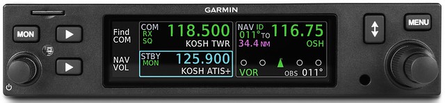

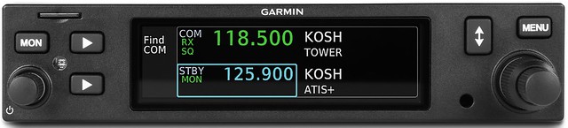

Hi everyone, the team continues working hard to bring new products to you. We’re proud to unveil the latest slim, 1.3” NAV/COMM radios the GTR 205 COMM and GNC 215 NAV/COMM.
GTR 205 COMM radio
GNC 215 NAV/COMM radio
Here are the high points:
  • 1.3” tall height, simplifies replacement of the popular Slimline SL30 and SL40 radios (requires rack and connector change)
  • Bright, beautiful, sunlight readable and color 3.2” wide display
  • Optional NVIS compatible display upgrade available within the unit
  • Large, easy to read fonts
  • Automatic frequency identification using an on-board database with GPS input
  • Frequency lookup using on-board database
  • Monitor the standby COMM frequency simultaneously with the active frequency
  • Press and hold the volume knob or frequency swap key to enter/activate the emergency 121.5 frequency
  • Setup and quickly recall up to 20 frequencies
  • Count up or count down timer
  • Optional remote key for COMM frequency swap; can install on the panel, yoke or other controls for quick access
  • Auto and manual squelch options and quick open squelch access with a press of the volume knob
  • 10-watt transmit standard with 16-watt upgrade option available within the unit
  • Pilot selectable frequency spacing supports regions that require 8.33 kHz frequency spacing, like Europe
GNC 215 offers adds a NAV radio with the additional features:
  • Course deviation indication with to/from leg status; still requires primary CDI
  • Distance and bearing to the station with GPS input
  • Automatic morse code station identification
  • Monitor the standby NAV frequency radial simultaneously with the active frequency
  • Pairs well with most analog indicators and Garmin G5, GI 275, G3X Touch and TXi Flight Display
The GTR 205 is priced at $2,695 and the GNC 215 is priced at $5,295. Orders can be placed with your Garmin Dealer now and we expect to begin shipping in March. These radios replace the GTR 225 and GNC 255.

I have recently purchased a GNC-255B and just installed it on my build. Is there any "buy back" program or incentive to update with the new radio model? Can you share the installation manual so we can assess how much work would be required in case one would like to upgrade?
You’ll have to forgive me but looking very close I notice a data card. Would this be another opportunity to sign up for data base upgrades?
Looks like it. A quick review of the Pilot's Guide states the microSD card is used for software and database of frequency related information updates.
These look really nice- any chance they also provide two place intercom like the GTR200? Or do these require an audio panel?
These specific models do not have a built in intercom.

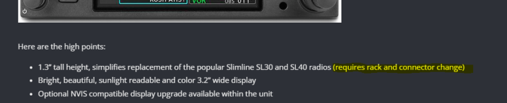

Will these fit in a gnc255 tray?
By chance, are they pin for pin compatible with heritage radios?
The connectors are different, you will need to depopulate the pins from your GNC 255 and repopulate them in the new connector. Everyone's favorite game of Operation. As these are closer to the physical dimensions of the SL30/SL40 radios, there is a different rack.

I'm not trying to be critical of a new product, but regarding the GTR 200B vs the GTR 205:
GTR 200B Pros:
2 place intercom
Less expensive
Bluetooth
Cons:
LCD screen
GTR 205 Pros:
Color screen
Easily up-datable
Cons:
More expensive (not sure if Experimental version will be produced, or less expensive).
No Bluetooth
No Intercom
Not a fair fight for a 2 place, simple experimental (RV4,6,7,8,9,12).
I guess it's main market would be for an additional radio in an airplane with an existing intercom that has the latest color screens so that it matches everything else.
Maybe I'm missing something here. Please let me know if I am.

Great that this has the same footprint! This will make a less difficult transition.
