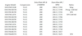

Have you considered the Titan (aka Continental) IO 340 or IO 370 ? The 340 is the same size as your existing 320 and the 370 is based on a parallel valve 360.
Constant speed prop is definitely the way to go. I have no idea on lead times these days or effects of recent change in corporate ownership .
I run an IO 370 with an MT 3 blade CS on my 7A. I upgraded from an O 360 with a 2 blade Hartzell. Both upgrades were nice improvements..
