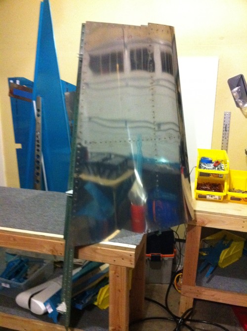

The best thing I've learned from lurking so far? Rounding the ribs in the VS to prevent the dings - and it worked! Skin is on for the final drill process and they are smooth and look great. So glad I found that information before getting started.

And a Vertical Stabilizer is born!

I wound up getting a pnuematic squeezer off the classifieds here for a great price. After doing the AD4 rivets on the VS spar, I knew I wanted something to set those a lot easier. I will primarily use my main squeeze where I can, and use the pnuematic to help in other areas. Last night I did use it to dimple all the ribs and spar of the rudder and it took less than 10 minutes to fly through them all.
